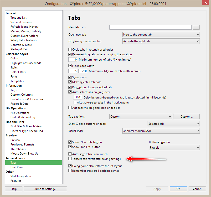

- Posts: 66360
Re: How to delete tabset list
Confirmed, something is wrong. I'll look into it later.
- Posts: 66360
Okay, I dug up the cause of this issue:
So, all you got to to do is tweak (https://www.xyplorer.com/faq-topic.php?id=tweak):
I admit I was surprised by this behavior myself and first thought it was a bug. So I'm ready to raise this tweak to the GUI. Any opinions?
v19.80.0131 - 2019-03-30 13:55
* Tabsets: Before, tabsets were revertible across sessions. If you did not
explicitly save a tabset you could always go back to the last-saved state
by clicking "Revert to Saved", and that worked across sessions. There was
a "temporary-saved state" in a folder called "t" (saved when doing a "File
| Save Settings") and a "final-saved state" in the folder above "t" (saved
when doing a "Tabsets | Save").
Now this behavior is a bit crazy since all other settings in XYplorer are
handled differently. Therefore I changed it: From now on tabsets are NOT
revertible anymore across sessions, but only within the session. If you
save settings, or exit the app with "Save settings on exit" enabled, then
the current tabsets (one in each pane) are *finally* saved to disk.
Clicking "Revert to Saved" will go back to that saved state.
Since this is an important change I cared for a soft transition:
- I added a tweak that allows you to stay with the old behavior:
TabsetsCanRevertAcrossSessions=1
- On upgrading to this version this tweak is automatically set to 1, so
nothing will change for you unless you explicitly change that tweak to 0:
TabsetsCanRevertAcrossSessions=0
- In a fresh installation, of course, that tweak is now set to 0 to enable
the new behavior.
- Note that, if TabsetsCanRevertAcrossSessions=0, any still existing
temporary states (in "t"-folders) are still *read*, otherwise you would
lose the last temporary-saved states of your tabsets and fall back hard
to the last final-saved states. After the next "Save Settings" these
folders will just disappear and never come back again.Code: Select all
TabsetsCanRevertAcrossSessions=1FAQ | XY News RSS | XY X

Too important to hide it as a tweak^^
- Posts: 66360
Yep. BTW, TabsetsCanRevertAcrossSessions as a name is not totally correct. It's actually "Tabsets can revert after saving settings" and that's what it will be called.
