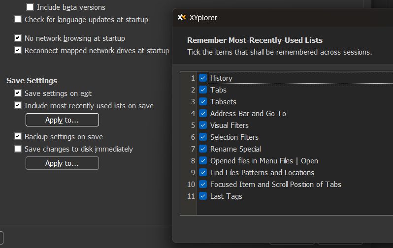

I have the same problem. I want a tabset to contain only the tabs I saved initially, but it doesn't. Any other tabs I open in that pane get auto-saved and added to the set.
In config/Tabs and Panes/Tabs, I have Auto-save tabsets on Switch unchecked.
In Startup & Exit/Save Settings/Include most-recently-used lists on save/Apply to, I have Tabsets unchecked.
I may be missing something, but if this is the way they're supposed to work, they're of no use to me.
