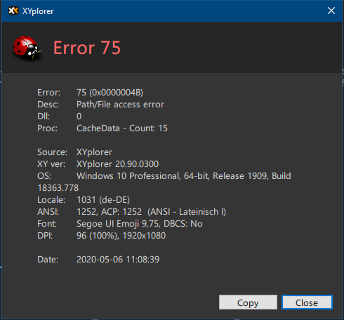

Version 20.90.0300 does not properly work. My thumbnail view is empty and when I try to refresh it with F5, I get error 75 (cf. attached screenshot).
2020-05-06 058 screenshot.png (32.08 KiB) Viewed 4686 times

Sorry, screenshot added. Something went wrong.

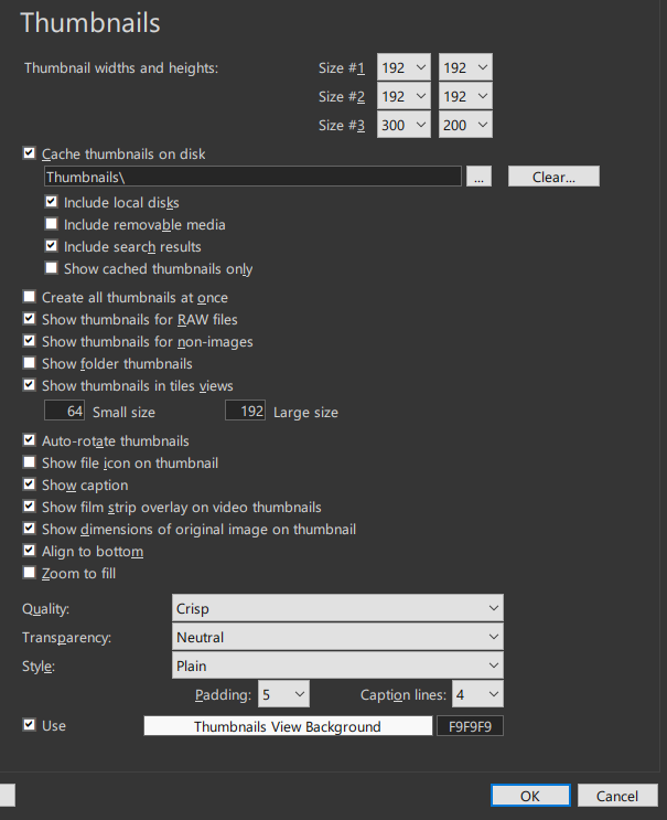

Show a screenshot of Menu - Configuration... - Preview - Thumbnails

Here is a screenshot:

Posts: 14639
Re: version 20.90.0300 crashes
Ok and my final guess: You are not starting XY with admin permissions.
-> XY has insufficient permissions to store the thumbnails in that path = the error you're seeing.
Do you have a file named "Startup.ini" in that path?
If not, create one, save it with UTF-16 LE with this content
[Appdata]
Path=%appdata%\XYplorer
and move your data files into that subfolder afterwards
If you have it, adapt the path in it and do the same (move your data files)...
