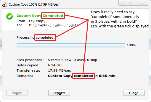

I'm still not entirely happy with the GUI of XYcopy and its siblings as per screenshots below.
Windows 7/10
Posts: 65255
Re: Tough words about GUI
It builds confidence in the user. :wink:
I see no way to make it better within the current layout.

admin wrote:It builds confidence in the user. :wink:
Software should project a sense of confidence implicitly. And if the layout does not support improvements then you change the layout.
I'd suggest removal of "Processing completed." and changing Remarks to Time taken as it's a non-verified copy. This would allow you to be succinct. If I had to design it, this is how I would make it look:
As you can see, very tidy, with no wasted space and all the same information provided in a more elegant way.
Windows 7/10
Posts: 65255
A screenshot is not enough to design a changing thing like a progress dialog. It's a machine with various states and routes. You'd rather need a storyboard approach. But please don't try to do this now, as I won't change the design anymore now. Possible future paths are already laid out in my head, so you have very little chances to add something valuable here.
But still I like your black + white sketchy design with Comic Sans font! One day I'll write such a skin for XY...

i kinda agree with zer0 that maybe there are too much of "completed" there. maybe it's better to a bit paraphrase it? for example "Processing ended" and "Custom Copy done in .. min".

eil wrote:i kinda agree with zer0 that maybe there are too much of "completed" there. maybe it's better to a bit paraphrase it? for example "Processing ended" and "Custom Copy done in .. min".
Yes, there are other similar words that could be used so there is a bit of variety..like finished/done/ended/etc.
