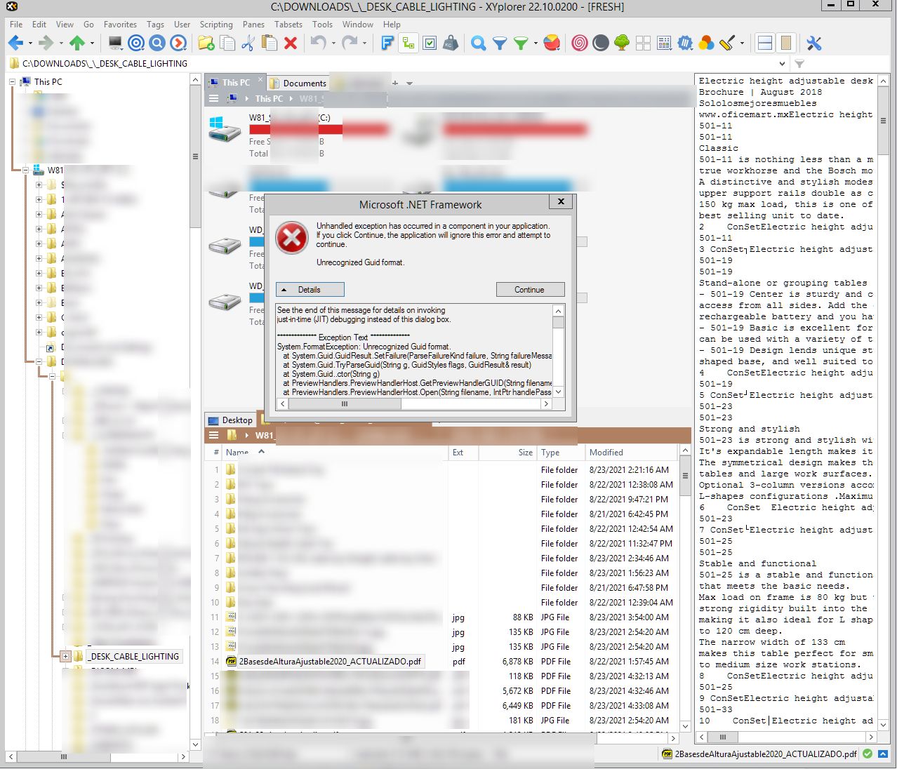

and then show a screenshot of the full XY window with the preview pane open and a .pdf selected

admin wrote: 23 Aug 2021 19:28 Screenshot not readable. Please use native attach function for images:
Did not notice. A bit sleepy. Sorry, here it is: Let me know if there' anything else ya need.
2021-08-23 22_43_02-C__DOWNLOADS_XYplorer 22.10.0200.png (449.47 KiB) Viewed 3122 times
Posts: 65418
Re: How to enable preview using Sumatra, while using Acrobat as default PDF editor
Are you using User-Defined Preview Handlers? Did you supply a valid GUID?

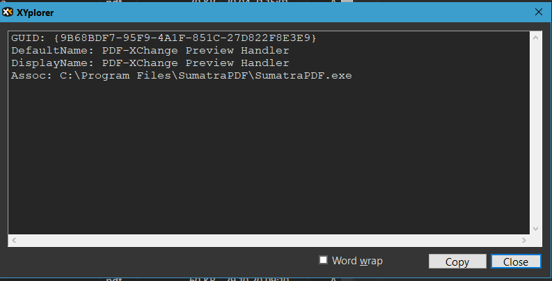

Execute this in the fresh and in the configured instance and post the results:
text get("previewhandler", "pdf") . <crlf> . "Assoc: " . get("assoc", "pdf");
Posts: 1355
Joined: 24 Jan 2021 12:27
Location: Germany
Post by Horst »
highend wrote: 23 Aug 2021 20:07 He does not, at least not in the fresh instance.
This does not give correct results in my environment.
I have installed SumatraPDF and its used if a PDF file is double clicked
but I have set the PDF-XChange Editor as PDF preview handler, which is realy used by XY.
The text get command line says SumatraPDF is preview handler which is wrong.
Screenshot - 23.08.2021 , 22_33_44.png (12.2 KiB) Viewed 3095 times
Screenshot - 23.08.2021 , 22_35_55.png (13.76 KiB) Viewed 3095 times
Screenshot - 23.08.2021 , 22_37_55.png (7.84 KiB) Viewed 3095 times

The return looks alright to me.
The first 3 lines are from:
text get("previewhandler", "pdf") . <crlf> . ...
The last line is from:
... "Assoc: " . get("assoc", "pdf");
