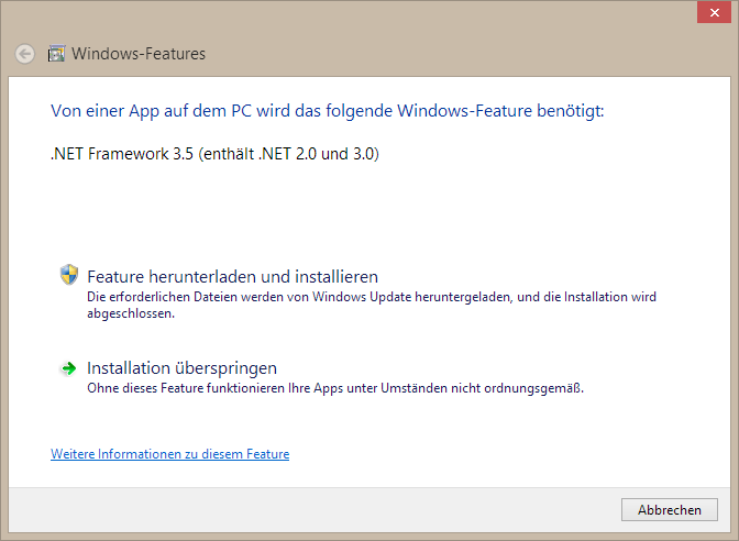

Sounds interesting but when I run PreviewHandlerEditor.exe I see this:
Strange, because I have .NET 4.8.03761 on my system. :? Any idea?
Posts: 14932
Re: How to enable preview using Sumatra, while using Acrobat as default PDF editor
You need to enable the .NET Framework 3.5 feature via Control panel - Turn Windows features on or off... - Wizard
Posts: 66160
Thanks. I assumed .NET was downward compatible. :roll:
Posts: 14932
Not with 3.5^^

It forced my to download stuff for minutes, and then this:
Link goes to this page where my error code does not exist: https://docs.microsoft.com/en-US/troubl ... tion-error
Thank you, Windows. Just great.
