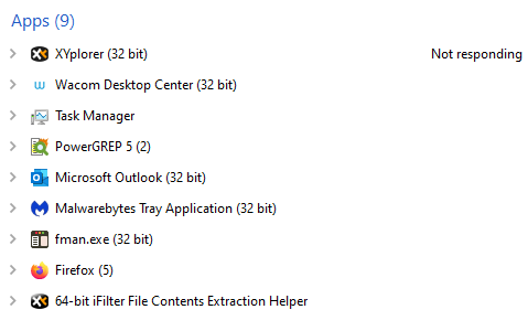

XYplorer keeps hanging when searching the content of pff files; when this happens a window pops up in xyplorer titled Contents64.exe which says (see attached screen shot) "Could not close the previous instance of this script. Keep waiting?". And the task manager shows a process running under XYplorer named "64-bit iFilter File Contents Extraction Helper" and under that process "Contents64.exe".

Yes, I start the search and this window pops up. If I choose Yes the window pops up again, if I choose No XYplorer moves on to a new file and then the window pops up again. If I try and abort the search by clicking "Stop (Esc)" then XYplorer completely hangs (see attached file xyplorerBug_3.png).

The task manager shows the content64.exe running under the ifilter (see attached png); if you try and end the content64.exe task it hangs, if you delete the upper task XYplorer moves to the next file to search and hangs again.
