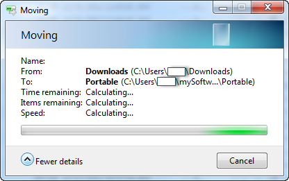

I downloaded a file, roughly 11MB in size, and attempted to move to another directory (left pane to right pane) and XYplorer freezes on me. Attached is the screen capture of the active window. I've hit CANCEL but nothing happens, currently, XYplorer is not responding.
C:\Users\Me\Downloads => C:\Users\Me\mySoftware\Portable\

After a long wait, I click on the X to exit the "moving file" window, then the attached window (below) appears. I make certain I exited XYplorer completely, restart the application, exit again and re-open, then attempts to move the same file again. Again, XYplorer freezes on me. I've performed this same function many times yesterday and today, with one file, many files, and it was fine.
