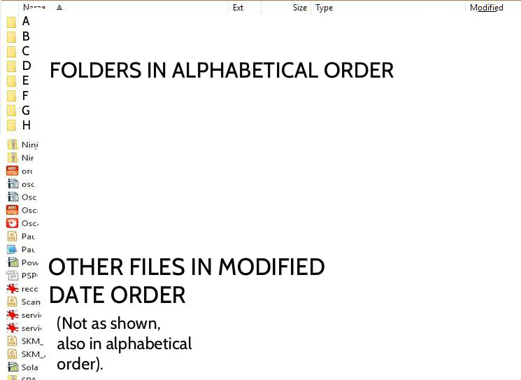

I'm just bringing this thread back from the dead because it's exactly what I'm trying to achieve. (but have failed).
So far nothing seems to work. To clarify; I am trying to have all the folder inside another folder in alphabetical order, then any other files that are in the same folder, in addition to all the other folders, are to be in 'last modified' order.

And now a real world example pleaseall the folder inside another folder in alphabetical order, then any other files that are in the same folder, in addition to all the other folders, are to be in 'last modified' order

Folders in alphabetical order, other files in last modified order. At the moment if you apply the fix suggested, then click 'modified', everything gets arranged in modified order. I want the folders to stay in alphabetical order.
EDIT: Solved it, all you have to do is Tools/Config/Sort and Rename/ Tick Sort Folders Apart/Keep Folders on top & Sort Folders always ascending.
Works for me anyway.
