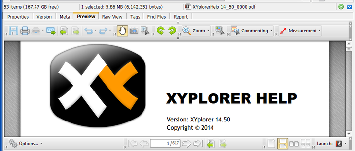

Some time ago I replaced PDF-XChange Viewer with their newer PDF-XChange Editor.
I'm unable to see my PDF's in thumbnails, MDBU or floating preview.
But, my PDF's will display in the Info Panel>Preview.
I've gone through my settings, Previewed Formats is correct and MDBU is set. With MDBU I can popup txt and doc (not docx) files but not PDF.

Re: PDF thumbnails, preview and MDBU not working
It shows in the panel.
