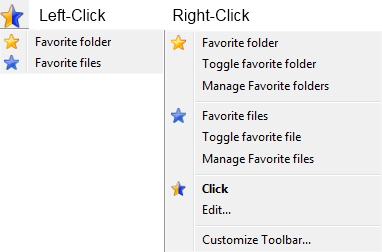

Favorite button- Combines favorite folder and favorite files button:
1) Left click: fav folder, fav file
2) Right click: fav folder, Toggle fav folder, Manage fav folder | fav file, Toggle fav file, Manage fav file.
Icon used:
MyFavsIcon.zip

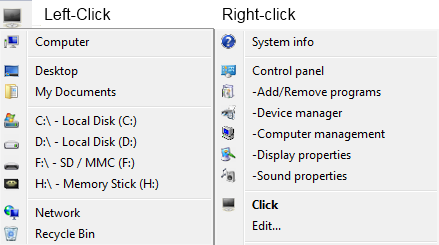

My Computer button- The default left-click options plus more options on right-click.
Download the below script and run once ONLY.
MyComputer_Button.xys
And if you like it, remove the default my computer button. :)

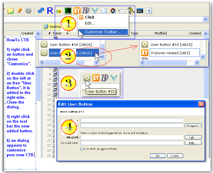

First let me add an little how to about CTB ("Custom Toolbar Buttons"):
See introduce of CTB at http://www.xyplorer.com/release_8.40.htm
5) Edit User Button:
Name: the tool tip, just an name or an description for this button. (like 'User Button #15' above)
Icon: path to an ICO file, or an EXE file, or an ICL file. Use /n to access an Icon from an EXE or from the Icon Library.
  (Examples: "path\icon.ico" or "path\ICONS\smily folder.icl /53" or "..\Beyond Compare 3\BCompare.exe" or "xyplorer.exe /2")
On Click: add an on-liner script, or click [Edit…] to write multi-line script, or LOAD to call an *.xys script file.
On right-click: LOAD an *.xys script to use this to show an context menu.

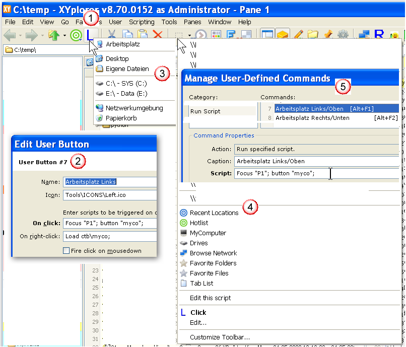

Here is my kind of myco button.
That is just an collection of ideas i had over the last months, to make the work with XY easy for my kind of use, but i am still not satisfied with it, but as always with improvisation... it just works and is enough for me right now, and i enjoy doing other things rather then improving this :lol:
Explanation of my myco picture:
1) i had add an "L"-icon for the left/top and an "R" for the right/down pane (see attachment, they are not good, but better then nothing)
2) my CTB settings
3) The script for the left click is just [ Focus "P1"; button "myco"; ] which focus pane1 and call standard myco command
4) For the right click i load an script file called myco: [ Load ctb\myco; ] where i collect some useful commands and some favorite UNC paths
5) i add also an shortcut to this button via UDC with the same code as for the left click: [ Focus "P1"; button "myco"; ] That way i press Alt+F1, the myco dialog pops-up, and i chose the drive to go to.
Download the below xys file, select it and run it ONLY once (eg: menu "Scripting > Load selected script file"):
Favsbutton.xys
After XY restarts, you will find it in the far end of the toolbar, you can set any icon to it. Maybe this icon too:
MyFavsIcon.zip

I am pasting a script showing system info and control panel etc:
"System info|C:\Windows\System32\shell32.dll /24"
  run "msinfo32";
"Control panel|C:\Windows\System32\shell32.dll /22"
  #640;
Caption and icon go on first line separated by a |. So in the first line:
Control panel is caption and C:\Windows\System32\shell32.dll /22 is my icon. Second line is the script itself, like goto or run or open etc. You can also have the whole thing in one line like i show below (I showed two lines just to make it clear). In your case you can paste something like this in your on-click or on right-click filed:
"My Notes | path to your Notes icon"  goto "C:/Users/Name/My Documents/My Notes"
"My Favorites | path to your Fav icon"  goto "C:/Users/Name/My Documents/Favorites"
Hope that helps.
