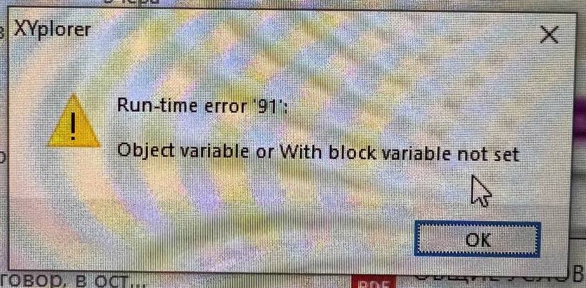

Hello!
When the program starts, the "runtime error 91 object variable or block variable not set" flew out, began in the latest versions.
The program sometimes starts without an error, but it loads and appears for a very long time - about a minute exactly.
What can this be about, how to fix the error?
Win10, XY 26.50
"Runtime error 91" when launching the program

1) Can you show a screenshot of the error message?
2) Can you mail XYplorer.ini to support [at] xyplorer.com?

1) To avoid long startup times due to unavailable network locations I suggest you check this box: Configuration | General | Startup & Exit | No network browsing at startup
2) Paste this script into the XY address bar and press ENTER:
screen;. Copy the contents of the returned dialog box and show them here in the thread.FAQ | XY News RSS | XY X

I did everything you recommended in step 1. I’ll watch it in action. When you restart the program, it opens immediately - works great. I won’t tell you by mistake yet, but I’ll let you know later. Thank you very much for your help!

What about runtime error 91? Did that go away?

At the moment everything is fine and the program starts immediately and there are no errors, I hope the problem is solved.
Thank you very much again for your help and prompt responses!
