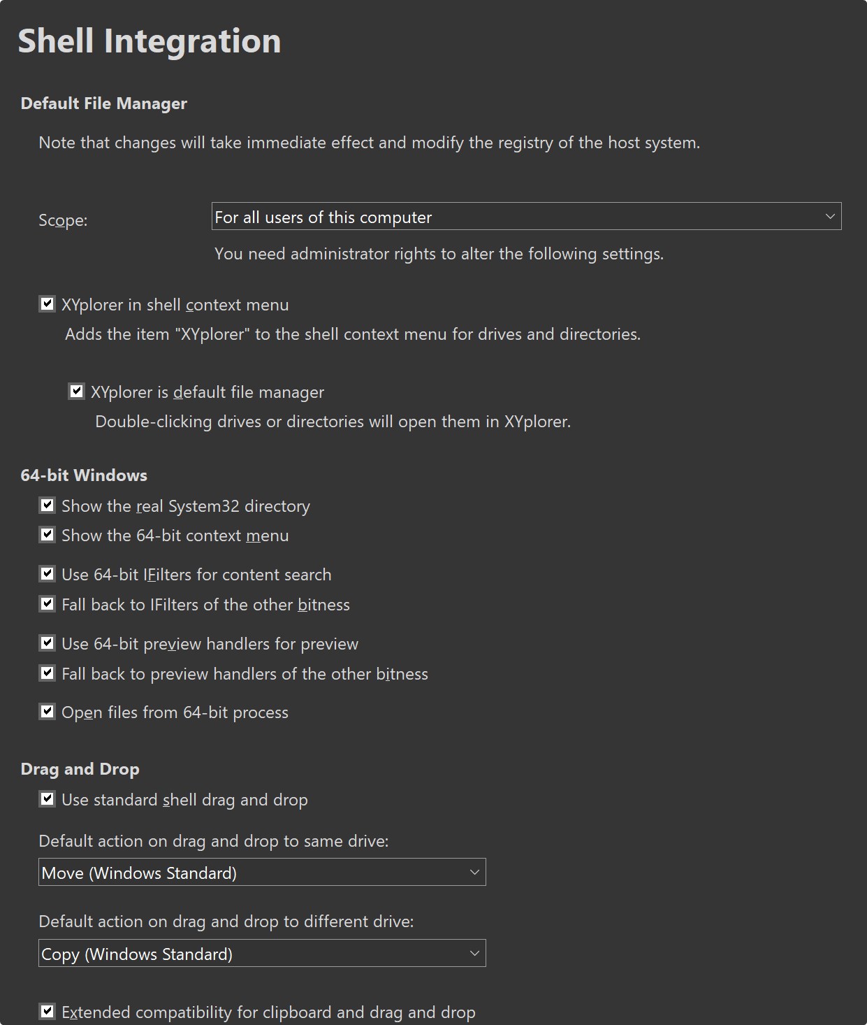

Try this: Configuration | Other | Shell Integration | 64-bit Windows | Show the 64-bit context menu

sorry its too big the picture
but its already enable

- Posts: 67256
kwanice
- Posts: 57
- Joined: 07 Aug 2022 13:41
Re: Xyplorer and 7zip
i did both...
enable/ disable/enable....
nothing works :s

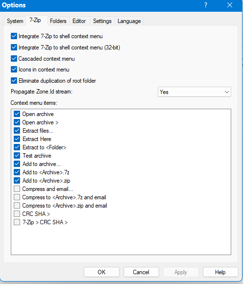

Your options in the 7zip file manager should look like this for the top level entries

thanks for your reply, and if portable version dont have proper explorer integration, why on explorer its working perfectly ? and not in xyplorer ?
i have these settings, and i can change/update the settings and it reflects perfeclty on explorer...but not in xyplorer

According to your Screenshot, an important setting is NOT set.kwanice wrote: ↑28 Dec 2024 17:47 thanks for your reply, and if portable version dont have proper explorer integration, why on explorer its working perfectly ? and not in xyplorer ?
XY is a 32bit program, and you don't have set the integration for it.

oh yeah...but its disabled... (i cant change this setting)
weird...
how u explain that it works on windows explorer and not xyplorer? even if this setting is not enable ?

Because the Windows Explorer is a 64bit program.

oh....true...xyplorer is 32....i forgot that !
do you have any idea how i can change that? i mean how i can see this submenu 7zip on xyplorer ?
(OS: W11 24H2 Pro OS build 26100.4946 - XY: 27.90.00.25 (64b) - Display: 2880 x 1920 @ 200% - Surface Pro 11 arm64)

I see 2 ways
- Installing 7zip x64 and set the options.
or
- Use a portable 32bit version of 7zip.

i found another thing, i installed nanazip, quite good, recognized of xyplorer when u disable show 64b menu.
and its compatible with unigetui
thanks for ur help
