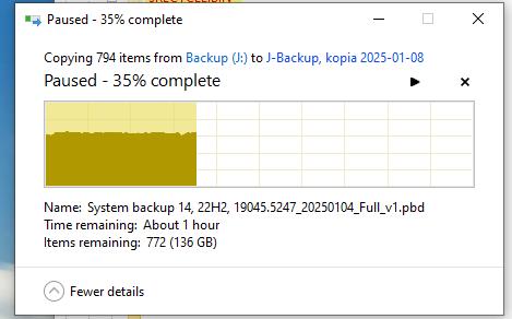

Better late than never, here is the data that I have and a picture of the program while in pause.
The quantity was 794 files with a total size of about 211 GB when I tried it again today. When it went into pause I don't know because of the total time of copying was more than an hour and the screen was in sleep mode.
The copying speed was about 40 MB/s. No other program was active during the session.
/Kent
Posts: 66583
Re: When copy a large Quantity of files, the XY goes into pause.
That is shell copy, owned and controlled by Windows. Only Microsoft knows why it pauses (but it's interesting, never heard of auto-pause).

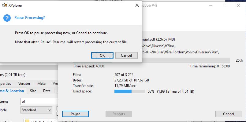

unfortunately it didn't work with your suggestions. Here is a new screenshot
Kent
Posts: 66583
You mean the "Pause Processing?" dialog comes up by itself?
kentcl
Posts: 16
Joined: 23 Jan 2013 18:56
Post by kentcl »
Exactly. I am now doing a number of large file copying just to check that I didn't push the button by mistake.
Kent
Posts: 66583
Something is sending a keystroke to the window. But I'm surprised that your other screenshot shows a paused shell copy, which surely needs a different key than XYplorer's progress dialog :?

I'll share a guess what may have being happening: if that was a number of copy tasks, when next task started XYcopy pops-up while user may be printing smth - that's how default selected Pause button gets "unwillingly pressed". Had this situation for myself, so maybe i'm not the only one.

I have just ended a copy operation of countless of files in different folders and partitions with a total of about 1 TB. During the transfer I didn't used the computer for other purposes and the complete operation did work perfectly without any errors at all.
That assures me that what happened the last time was, what you thought, a mistakenly pushed pause-button. So now we can leave this issue with the knowledge that, large copy/move operation doesn't always work in Windows 10 but, with the changes you advised me to do, works 100% in XYPlorer.
One suggestion though, wouldn't it be useful to have an acknowledge question, before "pausing/cancelling" copy/move operations in the background to avoid my kind of mistakes?
Regards Kent C
Posts: 66583
I don't think so. Pausing is completely harmless, you can resume the process at any time. Canceling might be something you want to do as soon as possible in case you made a mistake.
Well okay, when canceling, you could pause the process first and ask "Are you sure?" and cancel only if "yes", but resume if "no". What does everyone think?
