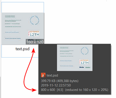

When Show Dimensions on Thumbnail are enabled they are incorrect for some files, presumably ones that can contain embedded thumbnails are showing the embed size instead, I will use PSD in the example, but from memory it happens with some other formats, eg.
Overlay Thumbnail dimensions can be erroneous
- Posts: 66585
Re: Overlay Thumbnail dimensions can be erroneous
Yes, it's the size of the embedded thumbnail. I think it should be shown here, since this is also the size you see when doing MDBU or Hover Box.
But I agree that this looks like a bug, especially since the feature is called "Show dimensions of original". So I will append the dimensions of the original in this case.
I only found it (and did it) for PSD files. Let me know if you find other extensions.
Personally I am surprised anyone would want the embedded thumbnail dimensions in this context, the way it is now you'll need a pretty large thumbnail to be able to read them both, but anyway it doesn't matter to me, I rarely work with psd.
- Posts: 66585
It tells you that the thumbnail/MDBU/hover box is made from an embedded thumbnail. Otherwise you would be surprised why they are so small.

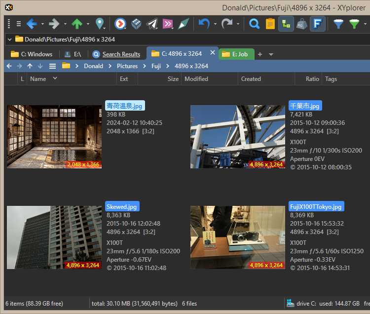

dahen
- Posts: 6
- Joined: 08 Apr 2016 21:06
I was surprised today why it (the label) was suddenly so big.
I was quite shocked and thought my XYPlorer was broken.
Sorry - It looks terrible and is absolutely unusable.
The text is wider than the thumbnail and already goes over the thumbnail of the file to the left of it.
If so, then make it optional or that you can choose which size you want to display. But the way it is now - it doesn't work. You can't work properly like this.
Thanks
Thanks

dahen
- Posts: 6
For PSD files, I personally don't really care what is displayed. The actual (larger) size is probably better than the "wrong" (smaller) thumbnail size.
Thanks for the quick response! Perfect as always.

Since you are using this, check out the changes (which I hope are improvements): viewtopic.php?p=218504#p218504
- Posts: 66585
And this with v25.50.0304 - 2024-02-23 10:55

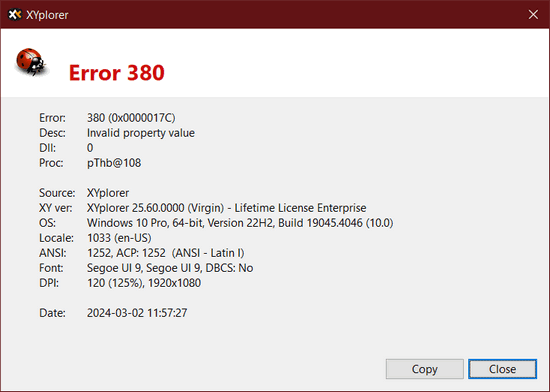

I have noticed that in fresh, if something like this is run:
this happens (repetitively):
goto <xydata>; view(5); thumbsconf(",,,,,,,1");this happens (repetitively):
- Posts: 66585
Confirmed and fixed in next beta.
