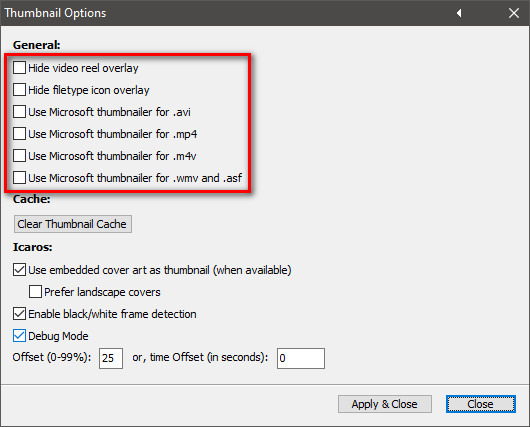

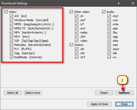

K-Lite_Codec_Pack_1715_Basic is installed and Icaros is used to create sketches. If you disable it, the error disappears. But at 23.40 everything works fine with Icaros.

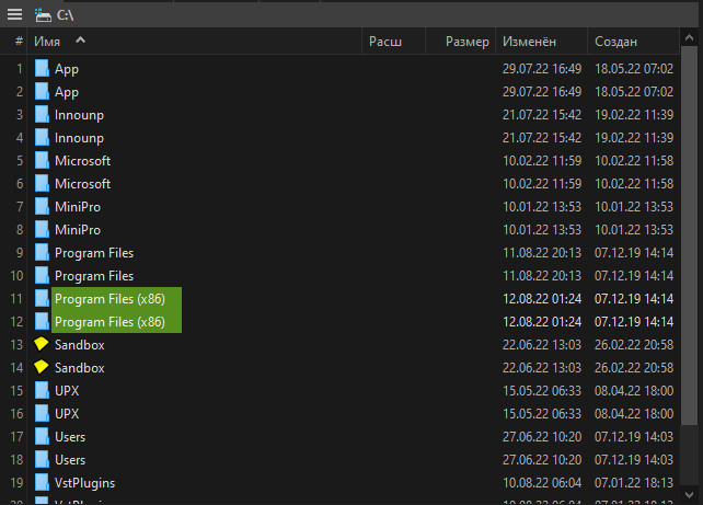

I also noticed that when creating thumbnails, double folders are displayed in another file panel. This happens only when creating thumbnails in another file panel.

But there is a problem with double folders in another file panel. At the same time, this happens when creating thumbnails for image files, but less often.

2) Totally weird. Have not seen something like this for years! Does it always happen? With any folder?

2) In XYplorer, I have two file panels displayed. In the left, for example, some folder is open, and in the right I open folders with video files or image files. So when creating thumbnails, there is a double display in the left file panel. This happens randomly, but it is at the moment of creating thumbnails (with a clean cache). And the longer the process of creating thumbnails takes, the more chances there are for such a glitch.
I.e. if a few thumbnails of images are created at a time, then there is little chance. And if several thumbnails of video files are created every time, then there are more chances.
Also, the chance increases if you enable the "Create all thumbnails at once" checkbox.
Windows 11 25H2, 100%
