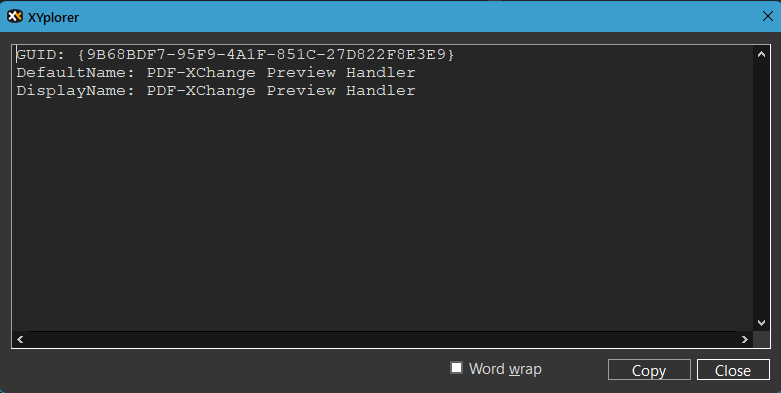

You don't use the PDF-XChange viewer.
Its the PDF Preview handler which comes with newer Edge installations.
If you switch to the PDF-XChange preview handler it looks like this
Screenshot - 13.04.2022 , 17_08_54.png (11.56 KiB) Viewed 4081 times

I just upgraded PDF X-Change Editor to the latest version and the output looks now like this:
GUID: {9B68BDF7-95F9-4A1F-851C-27D822F8E3E9}
DefaultName: PDF-XChange Preview Handler
DisplayName: PDF-XChange Preview Handler
Unfortunately it didn't change the experience at all, the hover preview is still small and past 260x260 the preview window doesn't get any bigger.
Actually the preview window is always the same (small) size and the pdf preview within that frame scales smaller from 260 down but not any bigger if wheeled up.
Ralph :)
