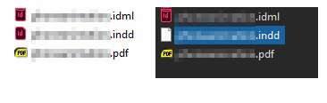

.indd files do not show their icon. See image. Windows Explorer on the left as it should be. XYPlorer on the right. .idml displays correctly, just .indd not working. I've tried many different fixes, including resetting the default app for this extension, uninstalling and reinstalling the application. I've tried custom icons. Digging into the application .exe file to check which icon is first, etc... Any solutions?

Open the registry and look at all occurrences of .idml and .indd. There has to be some suspicious difference. Probably related to 64-bit.

OK I searched for each extension. Each one has a (Default) REG_SZ entry. What am I looking for?

Follow the blood. The data field should contain something. Now follow that and so on. Until you see the truth.

If you just want to quickly mitigate it, you could use an alternate method and set the icon via CFI.
https://www.xyplorer.com/release_12.40.php#CFI
You might have to extract the correct icon from the Indesign exe/dll though, alternatively you might be satisfied if you just use an entry like this *.indd>*.idml since the icons are so similar, which in theory should work without any further steps.
