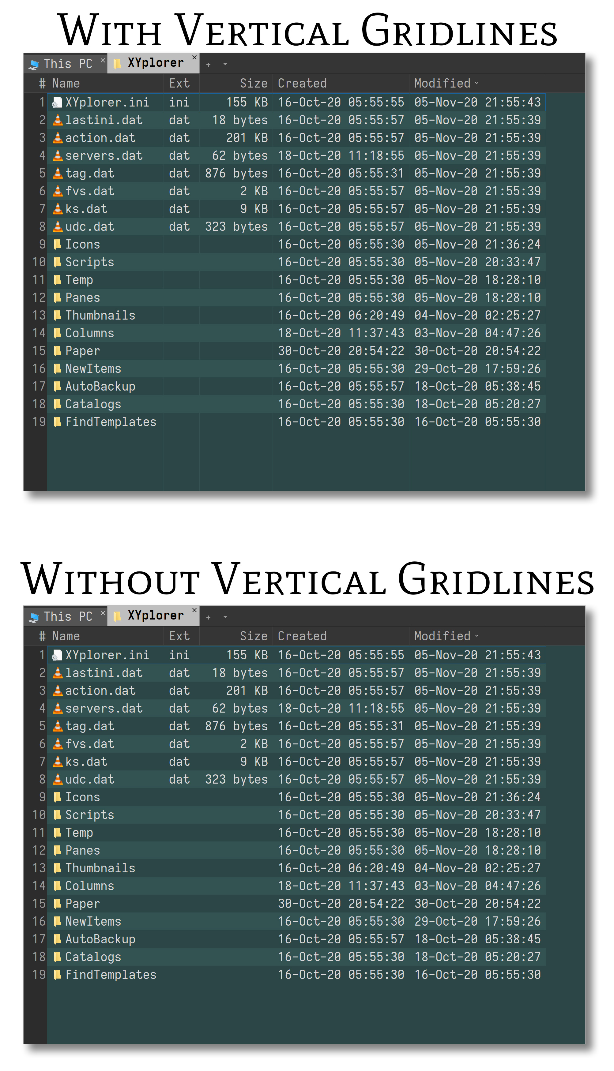

Vertical gridlines are almost invisible in 4k displays.
Is there a way to increase the thickness of vertical gridlines and/or change the color?
Attached photo shows the current appearance.

I think your main problem is that you have the grid zebra striping and the vertical grid lines, if you compromise and disable the zebra striping and instead maybe change it to horizontal grid lines and have the below setting disabled you should be able to see the lines easily with a suitable color.
Configuration | Colors and Styles | Styles | Semi-transparent grid color
A quick mock up:

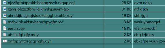

jupe wrote: 05 Nov 2020 20:41 I think your main problem is that you have the grid zebra striping and the vertical grid lines, if you compromise and disable the zebra striping and instead maybe change it to horizontal grid lines and have the below setting disabled you should be able to see the lines easily with a suitable color.
A quick mock up:
Not making any noticeable difference. Still very thin.
vertical gridlines-2.jpg (858.23 KiB) Viewed 3267 times
Are you testing it on a 4k display?

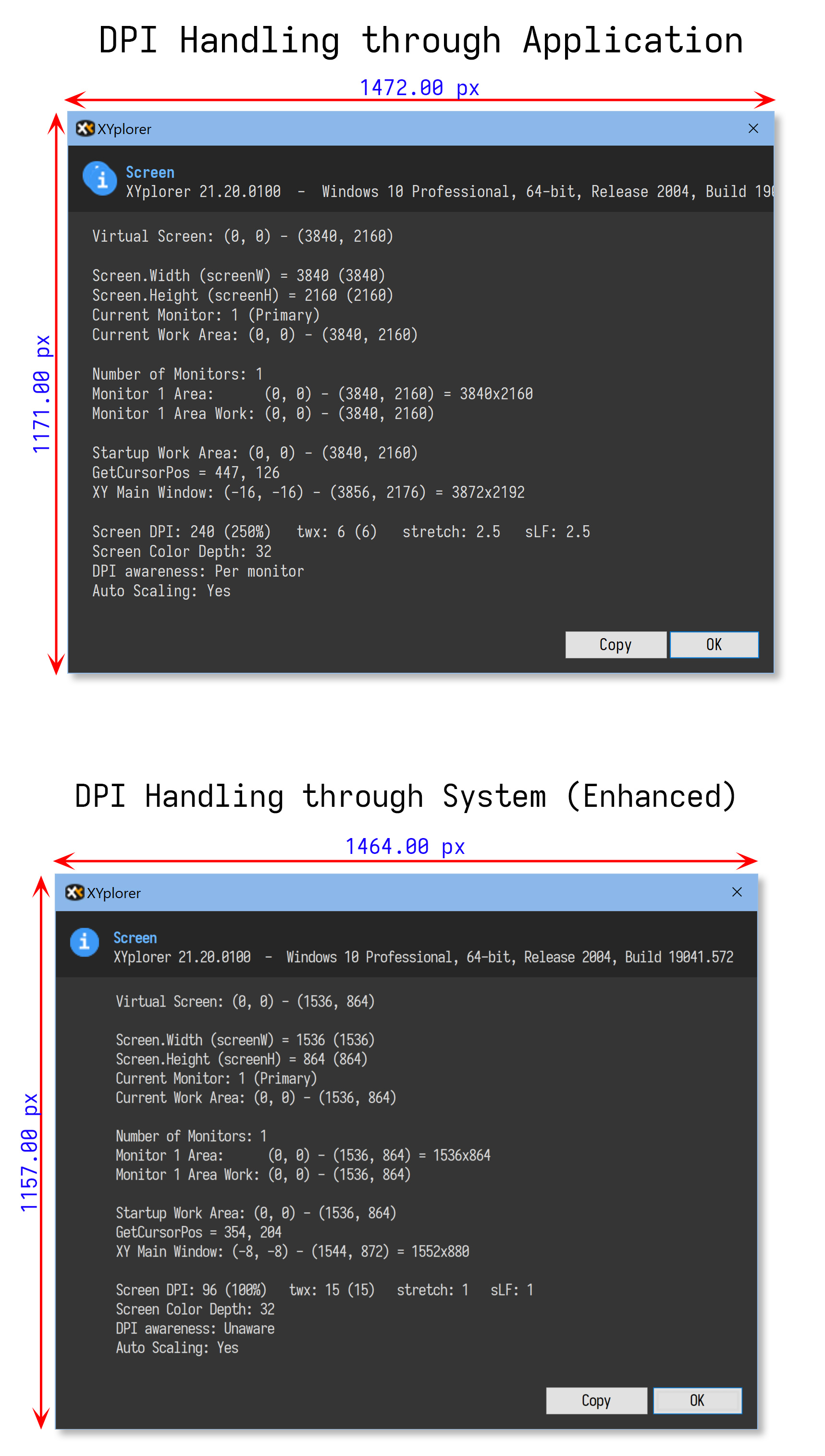

In the meantime, could you show me the returns of this command through address bar, please:
screen;
amirvf
Posts: 133
Joined: 18 Oct 2020 00:46
Re: Vertical Gridlines in 4k display
Post by amirvf »
admin wrote: 13 Nov 2020 09:57 In the meantime, could you show me the returns of this command through address bar, please:
screen;
Also note the adjustments done by "System-Enhanced" in the size of "Pop-Up Box", and "Font Size Inside the Box" which might be helpful to resolve 4k issues.

admin wrote: 13 Nov 2020 18:18 Thanks! The vertical lines problem exists in both cases?
The second scenario virtually resolves all 4k issues I have seen so far except the low resolution of default icons.
Vertical gridline, separator, etc are also acceptable after system enhancements.
But it has been resolved through a common template by system which is not suitable as a final resolution due to 2 reasons:
1. Applications which are initialized through XY, if DPI override is handled by system, show unexpected DPI behaviours. You could try opening a video file by VLC from XY while the DPI override is active and see the bizarre behaviour. To solve this issue, users should change the DPI override to "APPLICATION" (instead of system-enhanced) for each app which is initialized from XY and shows bizarre DPI behaviour, and this is very annoying.
2. Templates provided by applications to match 4k are generally more acceptable because they are customized specifically for this app by developer and do not follow a general custom template.
