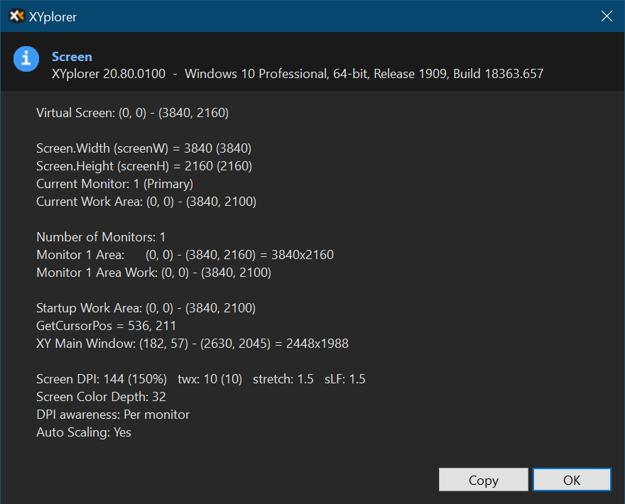

- Posts: 65412
Re: size of pdf MDBU preview
Please enter this into the address bar and press ENTER:
What is returned?
screen;FAQ | XY News RSS | XY X
