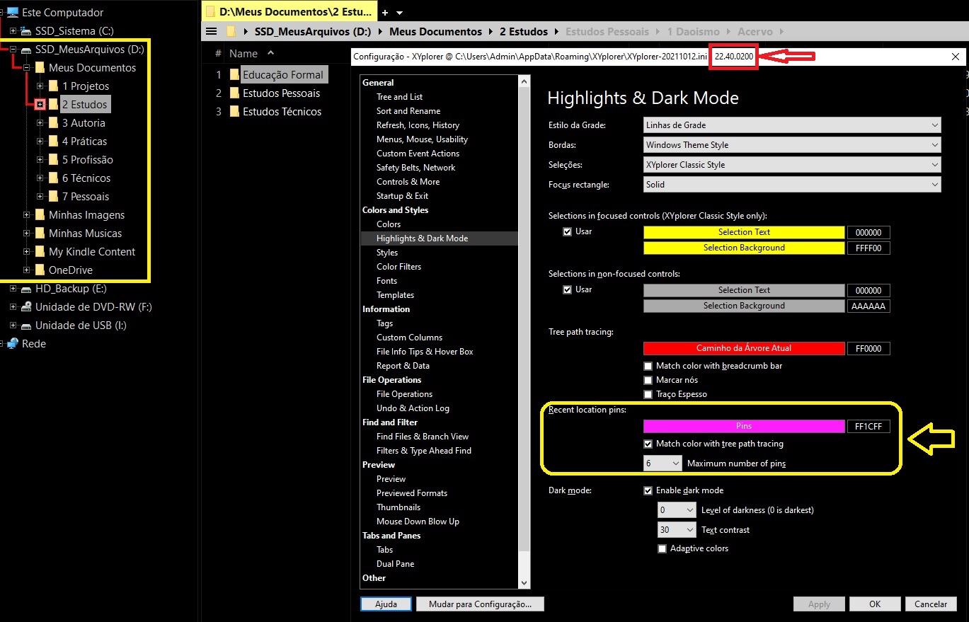

Re: Location pin colour
"Recent location pins"
According to the image below, the use of markings called "pin" how can you make it work?
I've also checked and unchecked the "Match color with tree path tracing" sub-option, but it still doesn't show up as arrows.
Thanks.
Thanks.
- Pins.jpg (267.17 KiB) Viewed 737 times
Do you have "Tools | Customize Tree | Recent Location Pins" activated?
