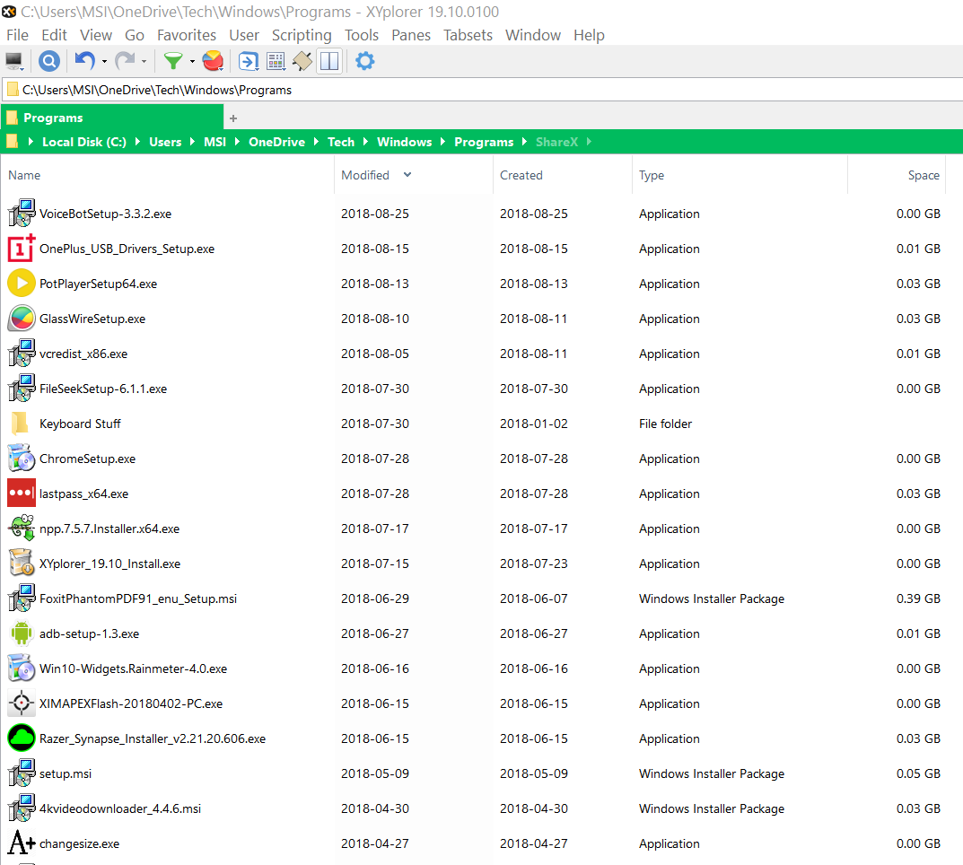

Thanks a lot for the fast & detailed response, but I am still slightly lost. I do not believe I have any custom column.jupe wrote:If you are using custom columns right click the column header, select "Configure Custom Column" then in the popup dialog change the trigger drop down box.
I have attached an image of all the columns I am using. Which one do you reckon I should disable to achieve the performance expected?

"Space" is not a standard column...I do not believe I have any custom column

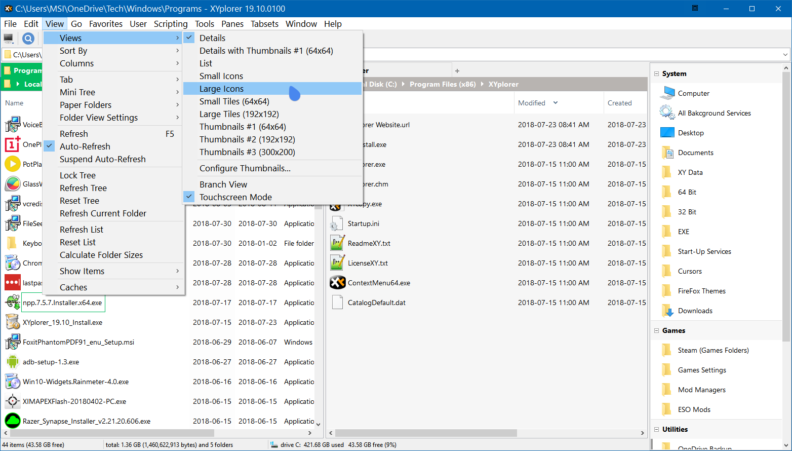

Show a screenshot of
Menu - View - Views
when inside this folder

Re: Slow Loading of Large Folders
When opening the folder for the first time after a restart\shutdown, this folder freezes for about 10 seconds. It has 44 items worth 1.36GB.

- Posts: 15009
Which language does XY use?
Help - Various Information, last line
What happens when you switch off
View - Views - Touchscreen Mode?
- Posts: 67010
I'd say Windows Defender is the culprit. Read this:
https://www.xyplorer.com/faq-topic.php?id=mse

H1313303
- Posts: 26
- Joined: 24 Jul 2018 08:43
Excluding it from the Windows Defender made it super fast, even with icons enabled. Thank you both HighEnd & Admin for your time and quick replies.
