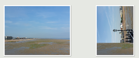

Thumbnails of 'portrait' pictures not shown correctly
Thumbnails of 'portrait' pictures are shown laying 'on their side' with the bottom of the picture truncated. The lower part of the thumbnail area still shows the remains of the thumbnail of (normally) the most recent 'landscape' picture.

Please see attached screen grab

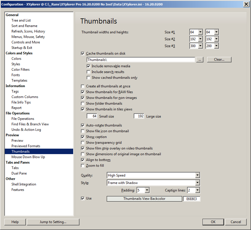

Re: Thumbnails of 'portrait' pictures not shown correctly
Care to upload that original picture somewhere?
Configuration | Thumbnails | Auto-rotate thumbnails
is checked?
is checked?
is checked? = Yes it is!

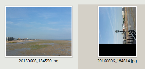

1. What happens when you select this image and use:
Menu - View - Caches - Refresh Selected Thumbnails?
2. If 1. doesn't help, does it work in a fresh instance? ::fresh; {ENTER} from the address bar
1. Gives the result below. Only difference is that the lower part of the thumbnail area is black instead of still showing the remains of the thumbnail of (normally) the most recent 'landscape' picture.
2. No further difference. Interesting that other thumbnails of 'portrait' pictures are completely unchanged after both moves.
https://dl.dropboxusercontent.com/s/0uy ... 3.jpg?dl=0

It has already been discussed before because this was my very same problem too. (I am lazy to search back.) You probably use the "Fast" quality method of creating thumbnails. Wrong. Switch to another one, because this one simply extracts the thumbnail saved into the jpg file. Or, if you stick to the "Fast" quality, you have to remove the thumbnail from the jpg, for example, using exiftool and this command:After that you will get the correct thumbnail.
And don't forget to refresh the thumbnail cache in case of any modifications.
exiftool -thumbnailimage= FILEAnd don't forget to refresh the thumbnail cache in case of any modifications.

Yeah, I've been having this problem too under windows 7 64bits, with all versions since I started using XYPlorer.
Switching from Tools Configuration > Thumbnails > Quality > High Speed to Fast seems to have solved the problem
Thanks for the help
