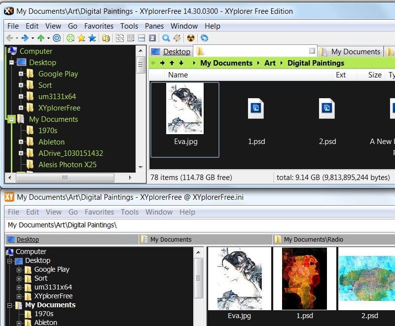

I've been using the old free version, 5.55.002 for a long time and it's been pretty great. Thank you very much indeed for making it available. I happened to see a post on the XY Facebook page recently and was surprised to discover there is a new free version. I downloaded it to try it out and everything seems lovely but for one problem. My old version displays my Photoshop PSD files as thumbnails but I can't seem to get the new version, 14.30.0300, to display them. I even installed the XnShell extension in the hope that might fix it but it still won't show them. I've attached a screenshot showing the two versions of XY running.

I figured it out. I went into the .ini file and found an entry:
PreviewPSDEmbeddedThumb=0
So I then thought that should be set to "1", changed it and now I have all my PSD thumbs!

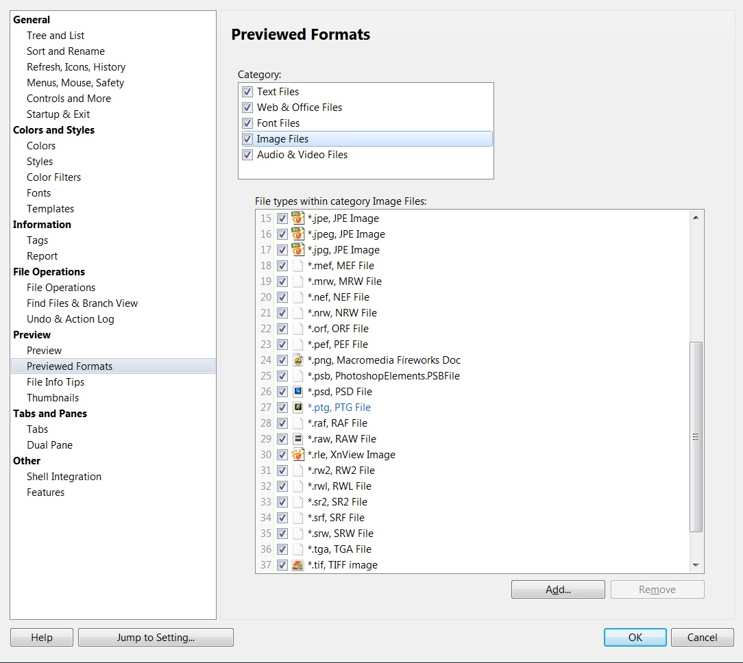

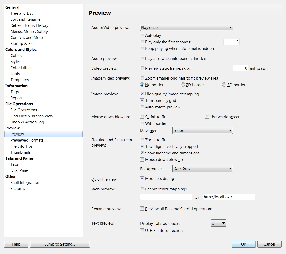

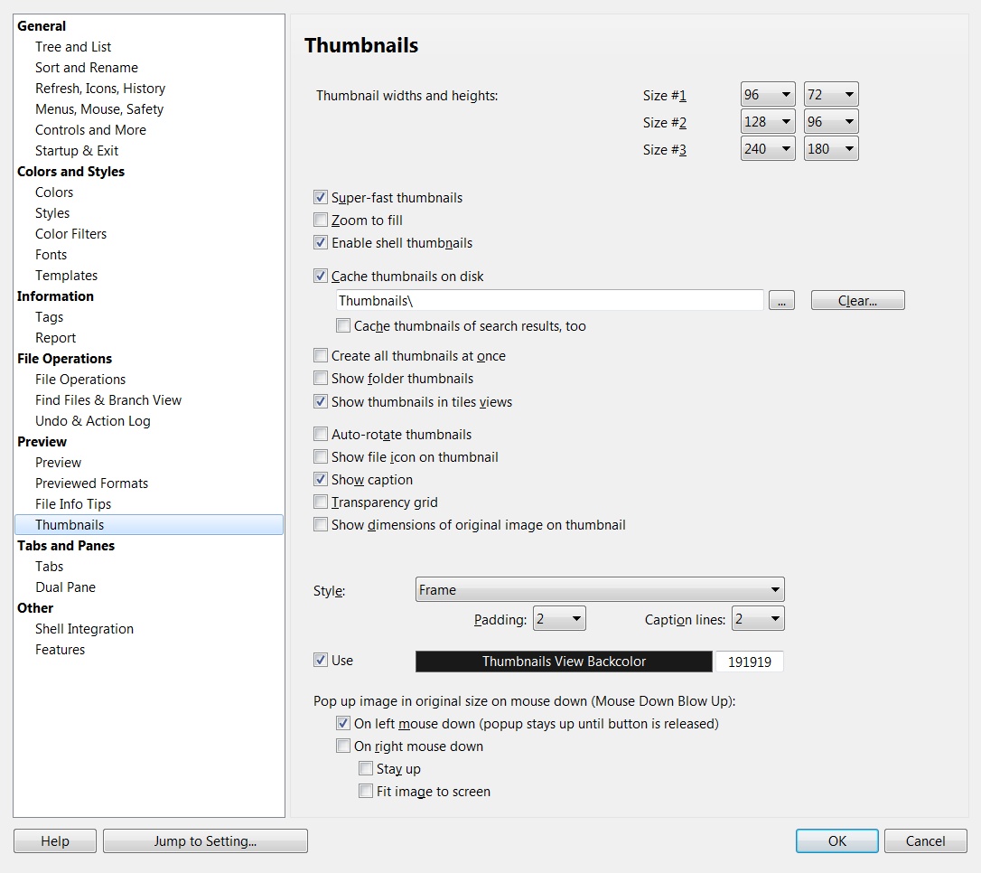

1) check a "fresh" XY instance by entering ::fresh into the Address Bar or copying the XYplorer.exe to a tmp folder and run it. Are the thumbs still missing?
2) post screenshots of the (3) settings pages, so that the thumbnail experts here (there quite a few!) could have a look

I certainly tried again with different instances of XY. I even downloaded it again to try that one. No luck though. Windows Explorer displays the .ptg thumbnails fine.
Here are the shots you asked for.

thanks for posting the shots. They indeed look fine, and I think the reason must be elsewhere.

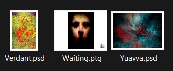

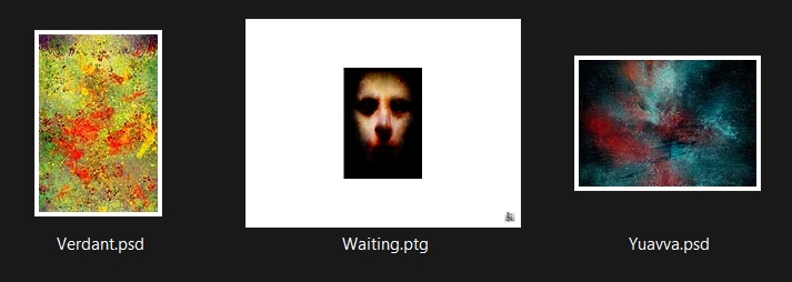

Thanks again chaps. It seems you were correct about the vagaries of the bit level. I installed the thumbnail viewer shell extension and now suddenly have my ArtRage thumbs!
There is something odd though. If you look at the screenshots you can see that they're not behaving like the other formats. The PSDs and JPGs conform exactly to my settings in XY whereas the PTGs have an excessive amount of white border and also do not change in size when I create larger thumbnail sizes! The PTGs are also the only ones to have a little icon overlay on them. Strange.
