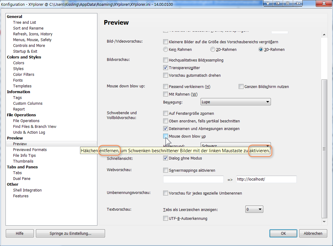

Help -- I urgently need PDF thumbnails to work, but performance is terrible.
After 3 thumbnails in a folder of 40 PDF's, XY would stop generating any more.
What's more, I don't want Mouse Down Blow Up and have deactivated it in the Configuration -- however it is still there (although incredibly slow on those PDF files).
Adobe Reader is freshly installed, also PDF-XChange Viewer. However, PDF thumbnails only work if Adobe Reader is set as standard PDF file handler.
Please help how I can fix those PDF thumbnails!
(in Windows Explorer, they work instantly in all sizes)
Regards David.P

And how can I get rid of that Mouse Down Blow In My Face thing ?!
Sorry this makes me furious

And I can't manually sort because when thumbs are shown (in thumbnails mode or in details & thumbnails mode), as soon as I try to start to drag an item, XY starts to to the Mouse Down Blow Up and won't let me drag.
