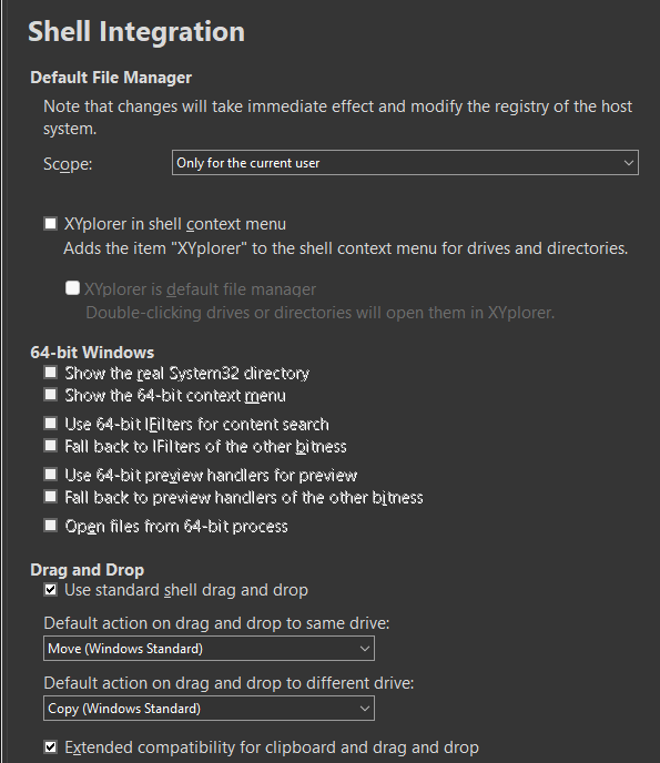

Still, Drag and drop only works when one item is selected.admin wrote: ↑19 Jun 2025 18:33 New version of XYplorer (64-bit) compiled with twinBASIC BETA 809:

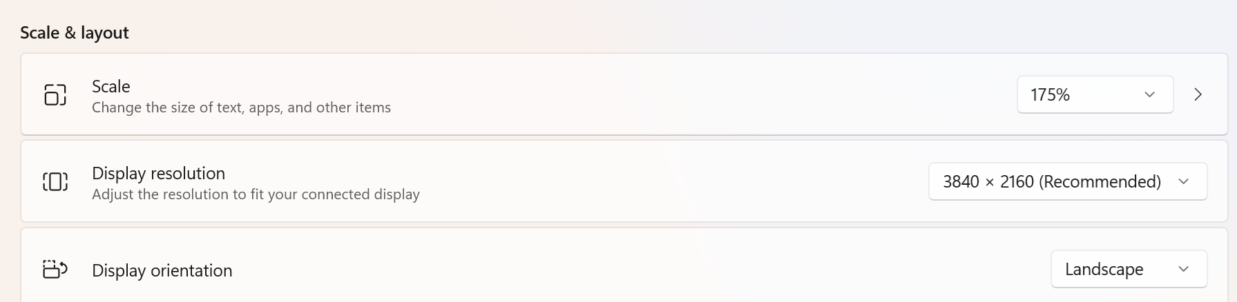

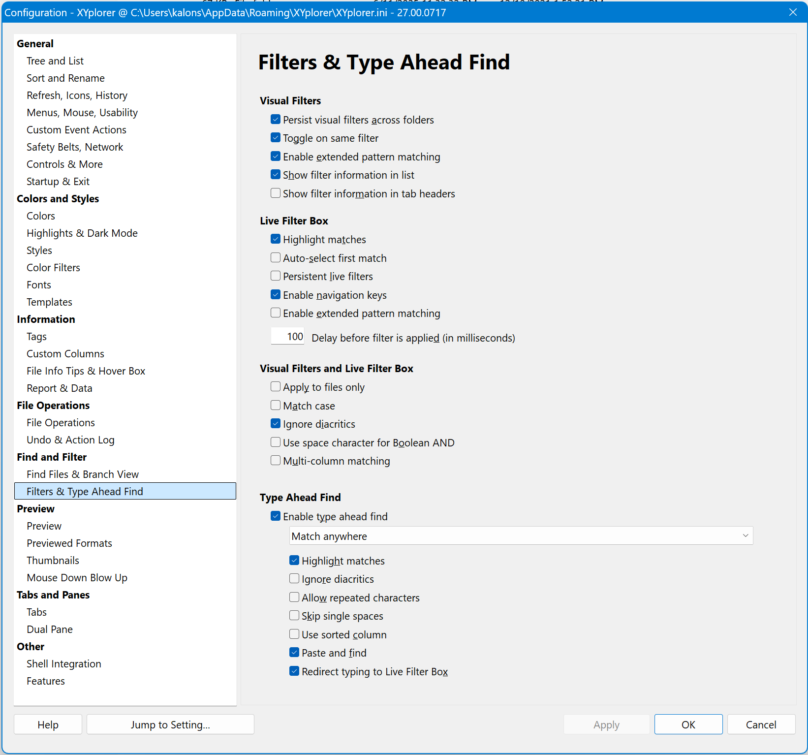

This is what 32-bit version looks like on my box. And 64-bit. Here are my display settings. Is there any way to configure the height of the dialog?kinook wrote: ↑18 Jun 2025 13:29 Am I the only one experiencing
1) Buttons not visible on the Configuration dialog (and in that dialog, I can click OK and get to the Jump dialog by judiciously using Tab and Enter, but it shows no buttons either)
2) Error dialog when choosing Quick View, followed by a quick view that only displays part of the first line of the file.
Is it being looked into (I provided the Various Information previously, but it hasn't been acknowledged)?
The above issue is only happening on my main desktop.
The Quick View issue is happening on another Windows 11 machine. Scaling is 250% and resolution 3840 x 2160, not sure if that is a factor.

- Posts: 66515
Can anyone with a similar scaling percentage confirm or refute this?

If this is ticked, drag and drop works just fine:Horst wrote: ↑20 Jun 2025 10:15Still, Drag and drop only works when one item is selected.admin wrote: ↑19 Jun 2025 18:33 New version of XYplorer (64-bit) compiled with twinBASIC BETA 809:
XYplorerTB.exe, v27.00.0716, NOT digitally signed, zipped
Configuration | Other | Shell Integration | Drag and Drop | Use standard shell drag and drop
Since the only advantage of unticking it is custom mouse pointers, I'm considering dropping that setting altogether and hard-coding it to "YES." The drag status box is much better than the mouse pointer anyway.
- Posts: 1396
- Joined: 24 Jan 2021 12:27
- Location: Germany
This option is already ticked and doesn't helpadmin wrote: ↑20 Jun 2025 15:51 If this is ticked, drag and drop works just fine:
if the TB version ir running in the VB dir.
Btw. the bad screen quality is only in the TB version.
The VB version has no such display problems.
More important, the TB version changes the settings in this dialog without any action from me
if it runs in the VB dir, and I can't change anything in this dialog.
This is also the case if I run the TB version in its own clean dir.
It's time to stop evaluaion of the TB version in this state.

- Posts: 1396
- Location: Germany
Using version 719 in a fresh dir.
I can't change anything under Other / Shell Integration.
All options stay as show in my screenshot from above.
Running XY VB, Total Commander, Free Commander and Everything without any glitch.
I'm sure that my PC configuration is not the problem in this case.
