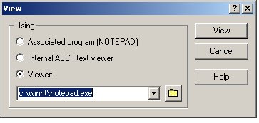

mwb1100 wrote:However, general purpose editing is such a big topic in its own right, and users have widely varying ideas about how an editor should work (and users tend to be quite set in those ideas - moreso than for filemanagers, I think), and there are already a bazillion editors out there from nice, quick, free ones to big, complex, expensive ones that it makes little sense for XY to incorporate this function natively. Just default to opening the file in notepad.exe, and users who want something better can configure for another commandline to launch what they want.
I basically agree with this and zer0's opinion about Pandora's Box...even my old WinZip which has a basic built-in viewer has option to define where to find an external viewer that isn't the normal for that file type...and then that can be used as option when "view" is selected:
Win Zip -- View options
SS XY - 11-26-09.jpg (14.88 KiB) Viewed 4105 times
Having this type of setup seems quite common and thus being available in all variants of XY should give more flexability without having to re-invent the wheel (and given that some want chrome mag wheels, much less work! :wink: )...
I don't quite follow the need to have both an editor & viewer definition...are there really that many cases where a viewer other than the Preview in XY already isn't enough? However, based on looking at a couple of other pgms, having some sort of a optional command/parameter string associated with the editor seems necessary...and being able to optionally locate the desired EXE via browse appears to mandate a second entry box for any parms/cmd.
