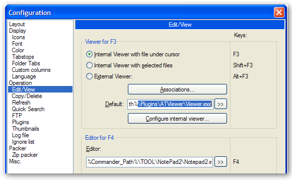

JimW wrote: Every single file manager I've evaluated has both a viewer and editor,
or at least the capability to configure an external program to use when a certain key is hit.
For example, TotalCommander uses the standard F3 key to view the highlighted file, and F4 to edit it (the key sequences used by the old Norton Commander from ages ago).
XYplorer doesn't have this functionality.

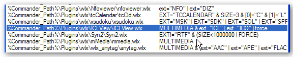

You may try "snippets" one-click solution for "F3 View" / "F4 Edit" as shown in "XYplorer behave NortonCommander"--thread ?
Or Portable Openwith Menu and Portable Openwith Menu
+|"Open with NP&P " *>"..\NotePad++\notepad++.exe"
+|"Open with &Notepad2 " *>"Tools\NotePad2\Notepad2.exe"
+|"Open with &Viewer " *>"Tools\UViewer\Viewer.exe"
+|"Open with IView" *>..\IrfanView\i_view32.exe
+|"&Launch with parameter" exe;cmd;bat;vbs>::Load "<xypath>\scripts\RunWithParameter";
+|"Script handling" *>::Load LoadInactiveselectedScript;
+|"NewItems>>" \;*>::Load CTX\NewItems;
+|"Packer" \;*>::Load "Tools\Packer\Packer";

But i missed an "View/Edit" menu entry first too as i was new with XY.
I was very wondered how to preview or edit an file in the first few days of using XY and feel very lost.
So i would suggest to deliver XY with such view/edit item with both link to notepad.exe as default
and the user should be able to config the tool to use (like TC does):
In the back that could be still pre-configured UDCs
but linked in the "Edit" menu as "Edit > View" and "Edit > Modify" or like this.
And then deliver it with an default hotkey, smtg with "F3" to call the viewer and with "F4" to open the editor would make this perfect.
Stefan

With TC you have an ini to define which file extension,
or which group like multimedia or even which file size should be open with what tool.
So my suggestion from above could be improved to use PFA instead of UDC.
So maybe deliver XY with an PFA-setup and Alt+F3 as shortcut.
With some configuration to open text files in notepad and pictures in paint or this MS-picture-viewer-thinggy.
Then if an user press Alt+F3 and depending on which file extension he do this, this file is opened or POM will presend him some alternatives.
The main point is to deliver XY with an pre-setup to use this out-of-the-box.
