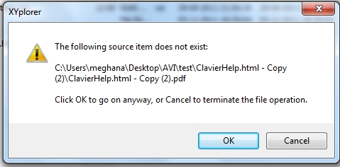

error is repeating in other systems also. i have checked in win7 32 bit and win 7 64 bit systems, but the error is popping up again.
case : i have created one folder called test. within test folder i have file ClavierHelp.html.pdf
and folder ClavierHelp.html - Copy (2). folder ClavierHelp.html - Copy (2) has ClavierHelp.html - Copy (2).pdf file. when i have used your code on test folder, the following errors popped up.

/* 05.11.2011, Move files and contents of folders to a different (new) folder
::load "<xyscripts>\.snippets\MoveToNewDestination.xys";
setting('BackgroundFileOps', 0);
$destination = inputfolder( ,select destination folder to move to);
$FolderList = get("SelectedItemsPathNames", "|");
foreach($FLD, $FolderList)
if (exists($FLD)==2)
$content = folderreport("files", "r", $FLD, "r", , "|");
foreach($Item, $content)
moveto $destination, $Item;
} else {
moveto $destination, $FLD;
delete 1, 0, $FLD;
kotlmg
- Posts: 321
- Joined: 30 Jun 2010 17:14
Re: script to copy sevaral folder contents into one folder
wonderful sir, the code is perfectly working as i desired. you are really a genius.
