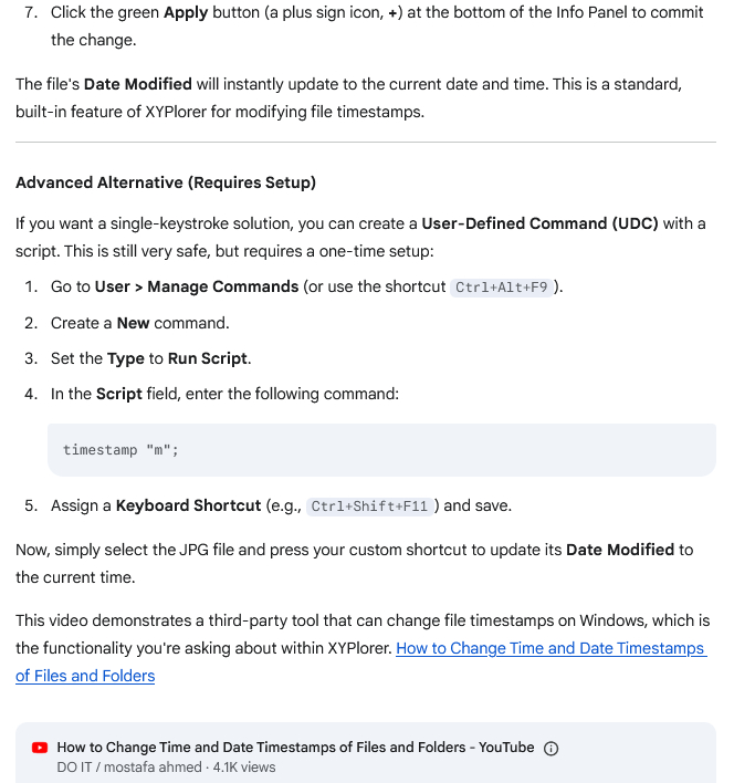

The attached is from Gemini:
One click on any file “and it jumps to the front of the line.”

- Posts: 14991
Re: One click on any file “and it jumps to the front of the line.”
And you don't want to use the way the AI suggested?

- Posts: 14991
What was suggested should work fine...

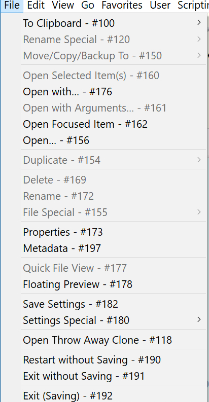

- Posts: 66496
There is even a menu command File | File Special | Set Modified Date to Current. Assign a shortcut to it and enjoy.

File Special #155 is greyed out. Which menu will turn it on? Anybody?
What shortcut name is safe from creating a conflict?
- Posts: 14991
Selecting an item would solve that^^

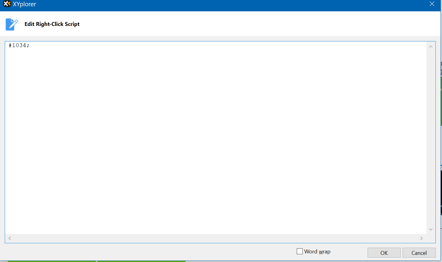

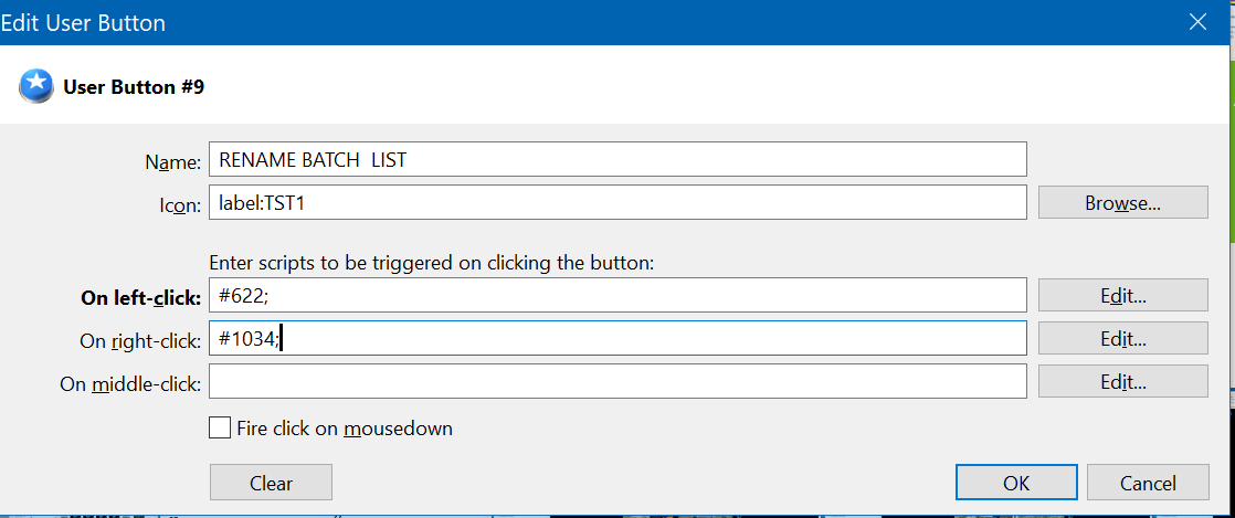

The command is #1034:
1. On right click I intended this item to be run. Not so. I have to click 1034 to get that. WHY NOT? Right or left does not seem to matter.
2. The above is run on the top menu. I would much rather hold down key + some key. Such as "Ctrl + Shift + U" and be able to click away.
The attached is what I have now. (Yes, I did enter a return + restart XY)
- Posts: 14991
You need a tweak for that behavior:
CTBNoRClickDefaultCommands=1
And when you want to use a shortcut, why don't you use a user defined command for it?
