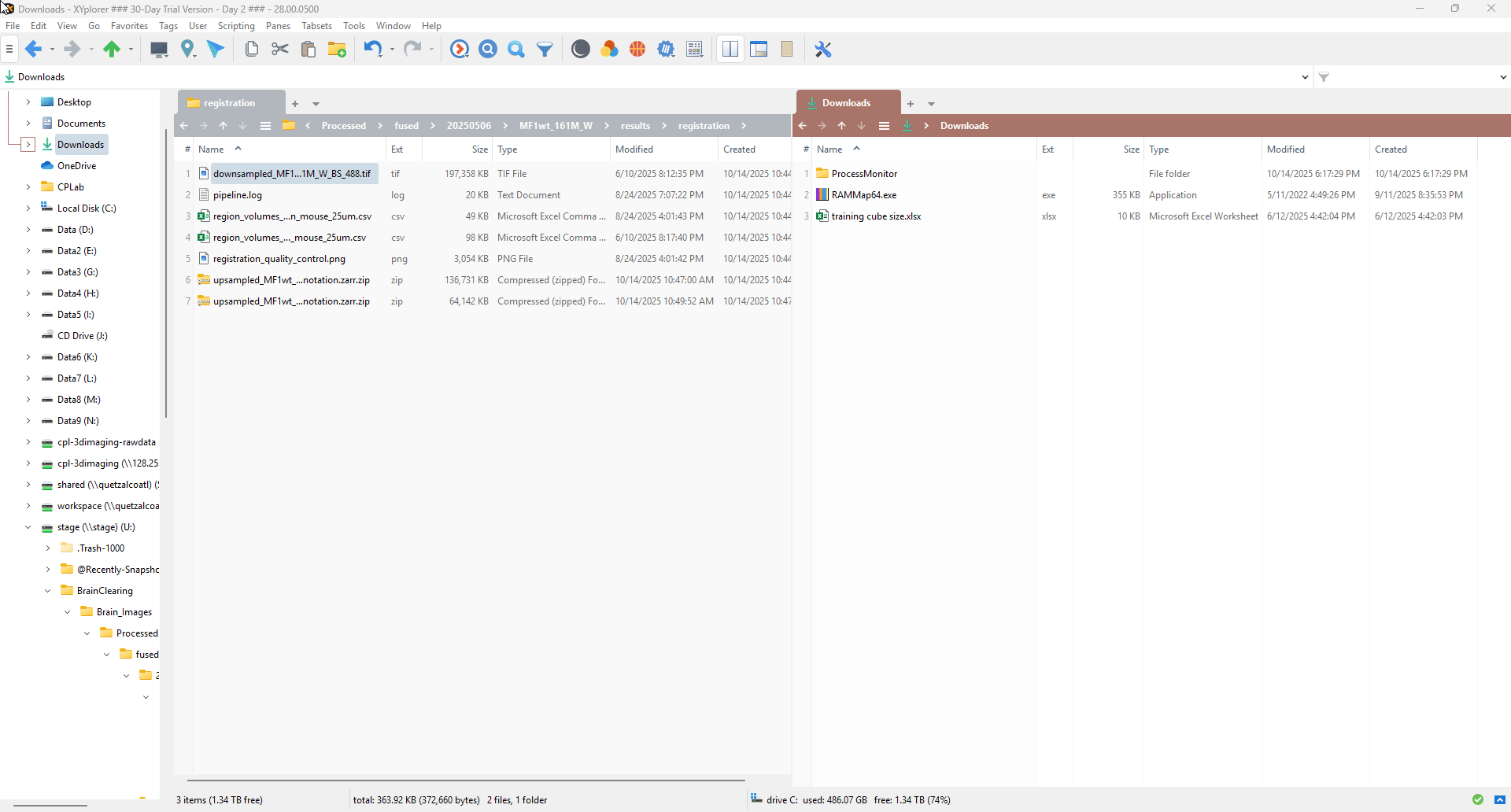

I just installed the trial version and so far it checks all my boxes. I have one issue though. I enabled verification when copying and now with every copy from the network, I get the an error, such the following:
Custom Copy from 10/16/2025 5:41:48 PM
From: U:\BrainClearing\Brain_Images\Processed\fused\20250506\MF1wt_161M_W\results\registration\
To:   C:\Users\CPLab\Downloads\
Excluded: Hidden files and folders
Files processed: 1 (0 new, 0 over, 0 skip, 1 fail)
Bytes copied:    192.73 MB
Transfer rate:   512.91 MB/sec (incl. MD5 verification)
Remarks:         Custom Copy completed in 379.4 ms (verified)
Warnings:        There has been 1 failed file.
Processed files:
FAIL (verification failed) New  U:\BrainClearing\Brain_Images\Processed\fused\20250506\MF1wt_161M_W\results\registration\downsampled_MF1wt_161M_W_BS_488.tif -> C:\Users\CPLab\Downloads\downsampled_MF1wt_161M_W_BS_488.tif | The parameter is incorrect.
If you look at the file size, it actually seems like the copy worked fine.
I'm using Windows 11, with 28.00.0500 trial version.
