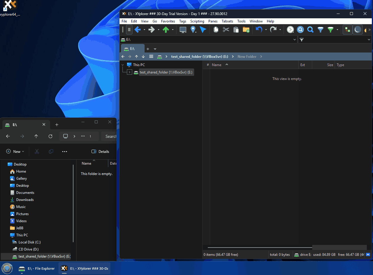

I just tested this with a VirtualBox Windows 11 Pro guest, mapping a shared folder as a network drive. When I rename that folder on the host (while the guest is running and not accessing the drive), and I try to access the network drive with XYplorer on the guest, XYplorer crashes (using my custom settings, as well as a fresh installation). Trying to access the network drive with Windows Explorer, I get the expected "Location is not available" error without a crash.
Could shared folders in VirtualBox be an easy and convenient way for you to test network drives?

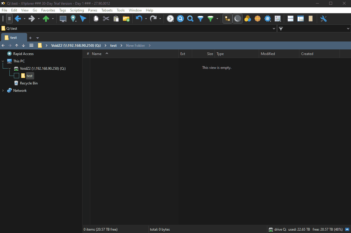

Alright, here are results from testing a fresh copy of XYplorer. There was one sure way to reproduce a crash on Windows 10 and 11:
1) Make a new folder on a mapped network drive in XYplorer (fresh installation with default settings).
2) Enter the folder.
3) Shift-delete the folder in Windows Explorer.
=> The folder remains visible in XYplorer and clicking on it crashes XYplorer
Remarks:
  • The folder has to be deleted with "shift + del", even though Windows always deletes files from network drives "permanently", and the deletion dialogues for "del" and "shift + del" look identical!
  • Several ways to access the non-existant folder in XYplorer lead to a crash: E.g. clicking on the folder in the tree pane, the breadcrumb bar, or refreshing the view (F5).
  • Refreshing the tree (F4) makes XYplorer detect the folder missing, and jump to the parent folder without crashing.
  • There are other ways to make a folder, e.g. in Windows Explorer instead of XYplorer, but they don't always lead to a crash.
  • The bug does not occur on a local drive or a USB drive, at least not with the XYplorer default settings.
  • When creating a new subfolder or a file within the deleted folder, XYplorer does not crash. It seems to tell the file system to create "\\network-path\New folder\New Text File.txt" as if "New folder" still existed, and the file system probably creates a new folder named "New folder", thus preventing a crash.
  • With my settings, XYplorer actually shows an "Access is denied" error in the file pane, after the folder was shift-deleted in Windows Explorer. But it still crashes when trying to interact with the deleted folder as described above. This one might warrant its own bug report because it happened in the old x86 XYplorer too, but it never bothered me much. Now, I suspect that this could be connected the the current crashing bug. Even though I have auto-refresh enabled, including on network locations, the old x86 XYplorer (often) wouldn't remove a folder in the current view/path after it got deleted (within XYplorer itself). It would still be visible in the tree, and the file pane would show an "Access is denied" error (possibly the response from Samba being asked for a non-existant folder). Navigating to a different folder would work fine. Trying to interact with the deleted folder would then make that folder disappear, instead of crashing.
  • I noticed something with the breadcrumb bar, and will write another comment soon ...
XYplorer x64 (often the latest beta), Windows 10 Pro 22H2, 3840x2160 scaling 100%
