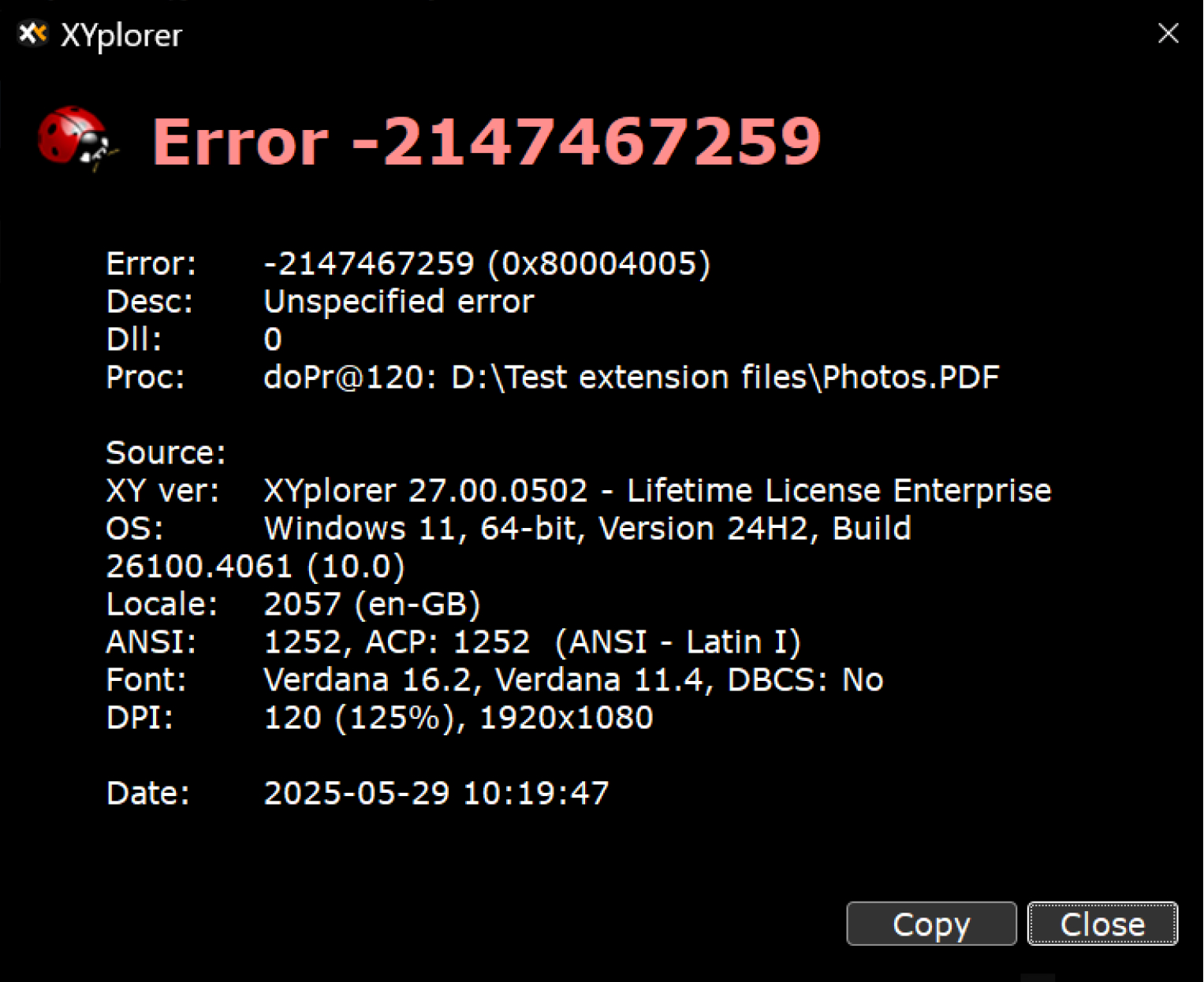

Don
When using Preview with Windows 11 and XYplorerTB-27.00.0502 the following file extensions create failures. All the same error code.
PDF, SVG, HTM, HTML.
When Right or Left, drag to move or copy Outlook .msg file to folder then
XYplorerTB-27.00.0502 crashes.
Both these failures are not evident on Xyplorer 27.00.0500.
Regards
Regards
- PDF error.jpg (595.08 KiB) Viewed 2259 times
- Posts: 65235
PDF preview works fine here. Which preview do you mean? (Info Panel, Preview Pane, Floating Preview?)
brianhuahin
- Posts: 106
- Joined: 03 Feb 2017 06:52
Don
All failing extensions fail in Preview Pane and Floating Preview. The Info Panel is selected and toggles and seems normal.
In XYplorerTB-27.00.0502 I moved PDF to Document Files from Web File and works file. PDF works fine in Xyplorer 27.00.0500 with same setting.
Other extensions still failing.
Hope this helps.
Hope this helps.
