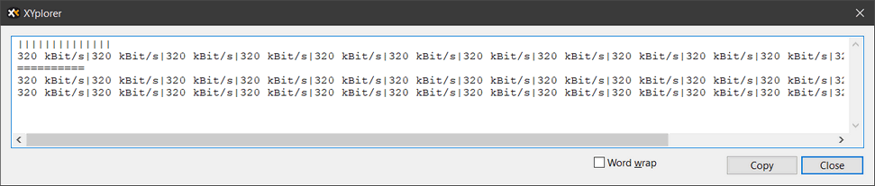

If there is no bug, and assuming you get output the same as me (risky...), can you explain why the results are different between the top and bottom sections? Just for a visual, below is a screenshot of what I get, so as well as itemlist 0 not working on CC#1>10, notice that Custom 11 which should be "Channels" is returning the values of Custom 10 instead somehow.

Okay, that was a deeply rooted bug. Took me 4 hours to get down to it and fix it. Try the next beta. :cup:
