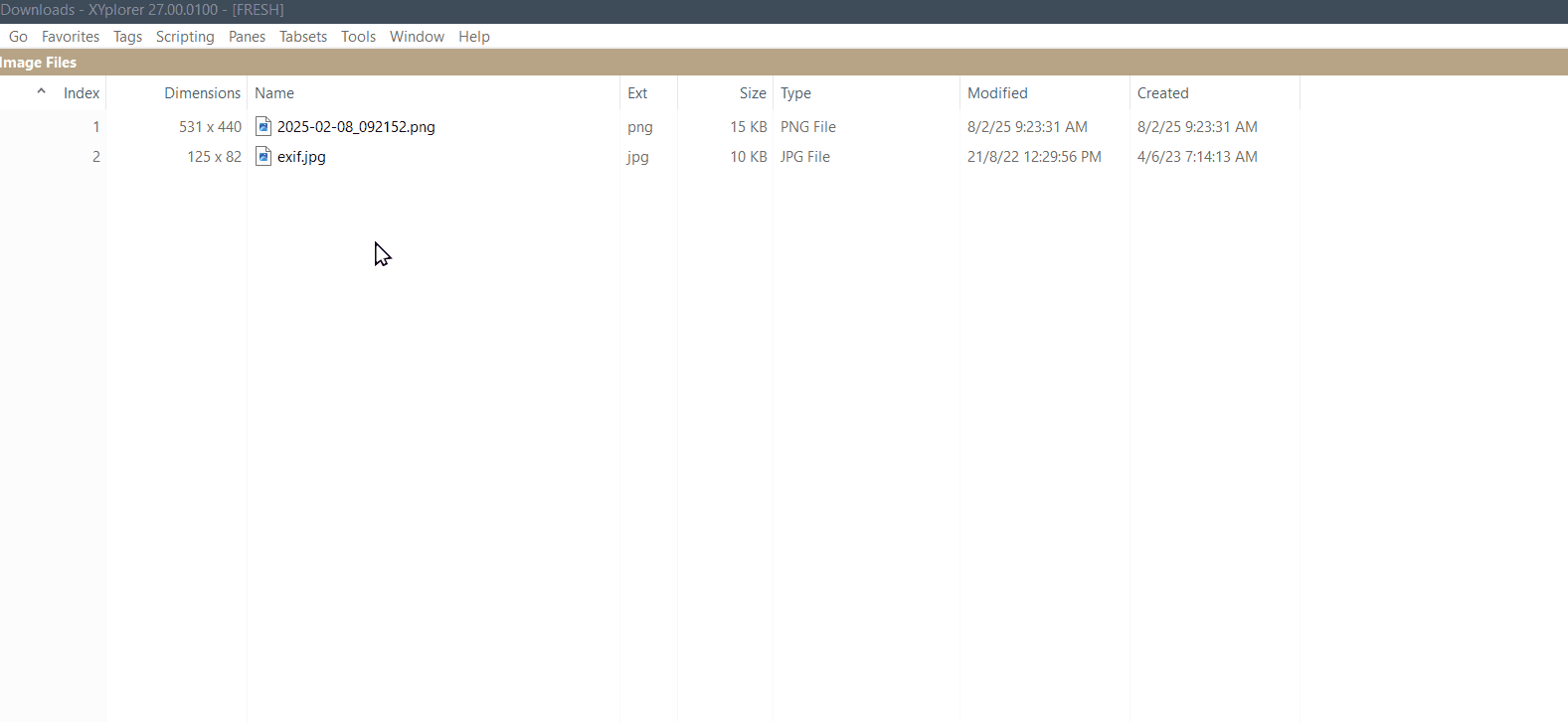

2) So if you go into a fresh instance and run both those commands as 1 script, you get a return for both? I only get a return for the first one, even if I've added Custom Column 1 to the list.
Posts: 66536
Re: SC report
Yes, but only if images are listed. {Custom 1} by default is Dimensions.
Posts: 3462
Re: SC report
Yes I realize that, but I don't get a return. eg.

Yeah I am still mystified how you didn't see it yesterday either. :arrow: It seems to matter how the column is originally added to the list, if done via Show Column it works for me too, if done via Add Column, it fails for me, so that's possibly the difference between us, I think I have demoed this discrepancy in the script below. Although what you said in your last post doesn't make sense to me because in the GIF I previously posted, it clearly shows that I have the column visible so the info IS present in the list, but like I mentioned in my last post, the issue only happens in CC#1>10.

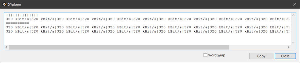

If there is no bug, and assuming you get output the same as me (risky...), can you explain why the results are different between the top and bottom sections? Just for a visual, below is a screenshot of what I get, so as well as itemlist 0 not working on CC#1>10, notice that Custom 11 which should be "Channels" is returning the values of Custom 10 instead somehow.
Crazier still, if I add Custom 16 to the list, then Custom 11 gets reported correctly, but only when it should be reporting on Custom 16! eg.
