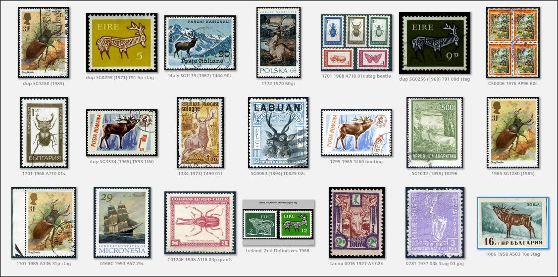

I cannot see "match exact word" so how may I find "Stag"
without 100's of results with "postage"
Thank you.
Also when I am in a folder of say 1000 images
when I hit right arrow, for next image, the result seems to jump all over the place
does not select the next image in line (sorted alphabetically)
Thank you for any assistance
Rod
Thank you.
Rod

So let's clarify
I have 500 or so folders, each with say 1000 images
I use quick search, which is fabulous but "stag" brings up unessassrily words like "postage"
I have gone to "i" for syntax but not astute enough to find a solution
stag* does not work
I am working with *.jpg files and searching on image captions / file or image names.
When I open a folder of images
right click will move on to the next image alphabetically ...good
down arrow moves to next line down
However, I want to "Toggle" two adjoining images, to detect postage stamp forgeries or varieties
so I click on the first image to bring it to full screen, then click right arrow, but that brings up seemingly random images in that folder
not the next alpha adjoining image
Any ideas?
Nothing worked.
So let's clarify
stag* does not work
Any ideas?

- Posts: 15016
Re: Quick Search (F3) How to search exact word-STAG without POSTAGE
>\bstag\b or stag /wOne of my scripts helped you out? Please donate via Paypal
Yay! Stag /w worked
You are a legend
Searched 400,000 images in a few seconds, with my result
I'll make a donation, how much is suggested?
You are a legend
