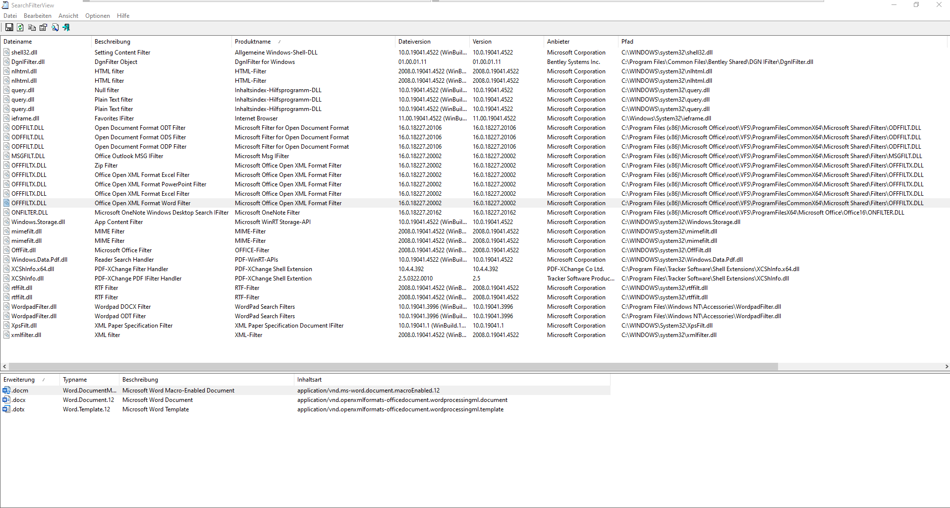

M.Me
- Posts: 5
- Joined: 20 Dec 2024 13:56
Re: very slow content search
These are the IFilters that are installed on this computer (see picture).
For the docm files, the same IFilter with the same version is also installed on all other computers.
- Posts: 15016
Installed in the x86 path -> 32-bit
And now the same picture for one of the other 9 computers?

M.Me
- Posts: 5
Here is the picture from another computer.
- Posts: 15016
And there you have it.
1. Your computers aren't identical
2. For whatever reason: Using the 32-bit filter seems to be faster than using the 64-bit one
Best option: Use Everything and the script integration so you'll have access to the Windows indexing service that is most likely making Windows Explorer so fast
