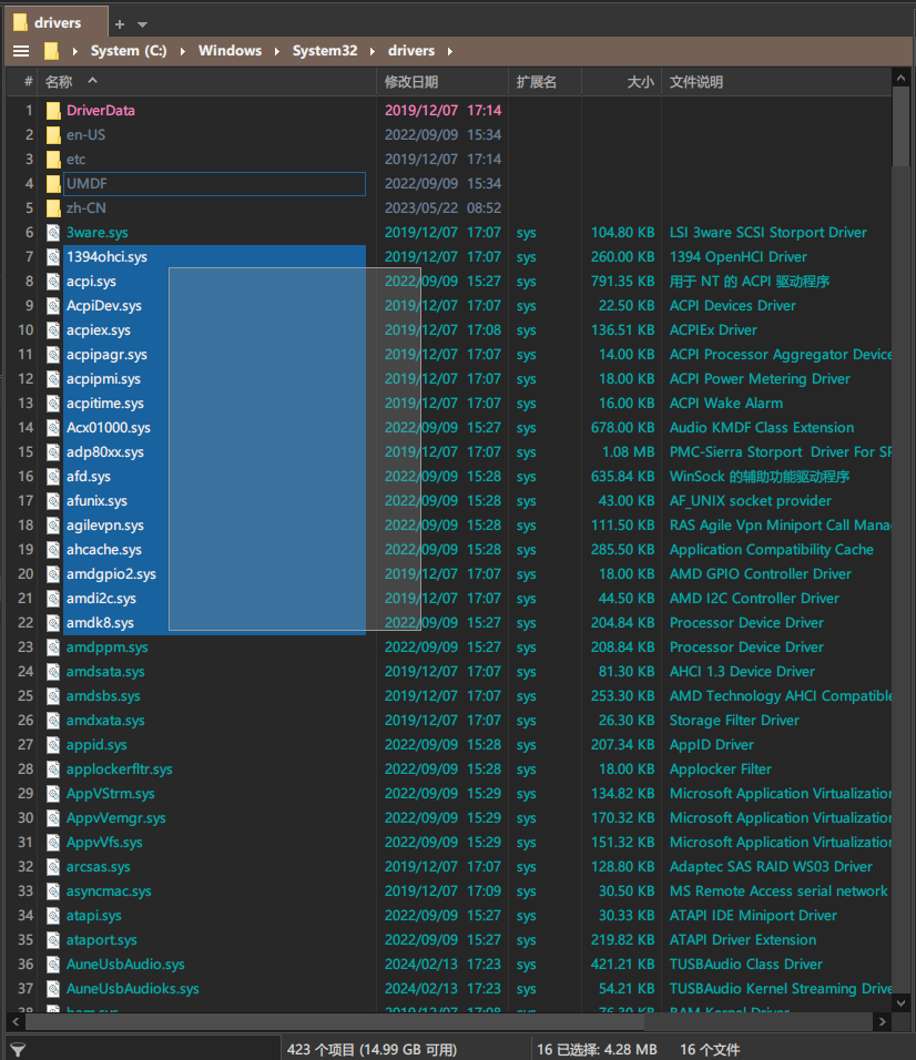

1. Hold down the left mouse button to select multiple files and quickly move the selection box away from the files.
Perform the action quickly repeatedly without releasing the left mouse button

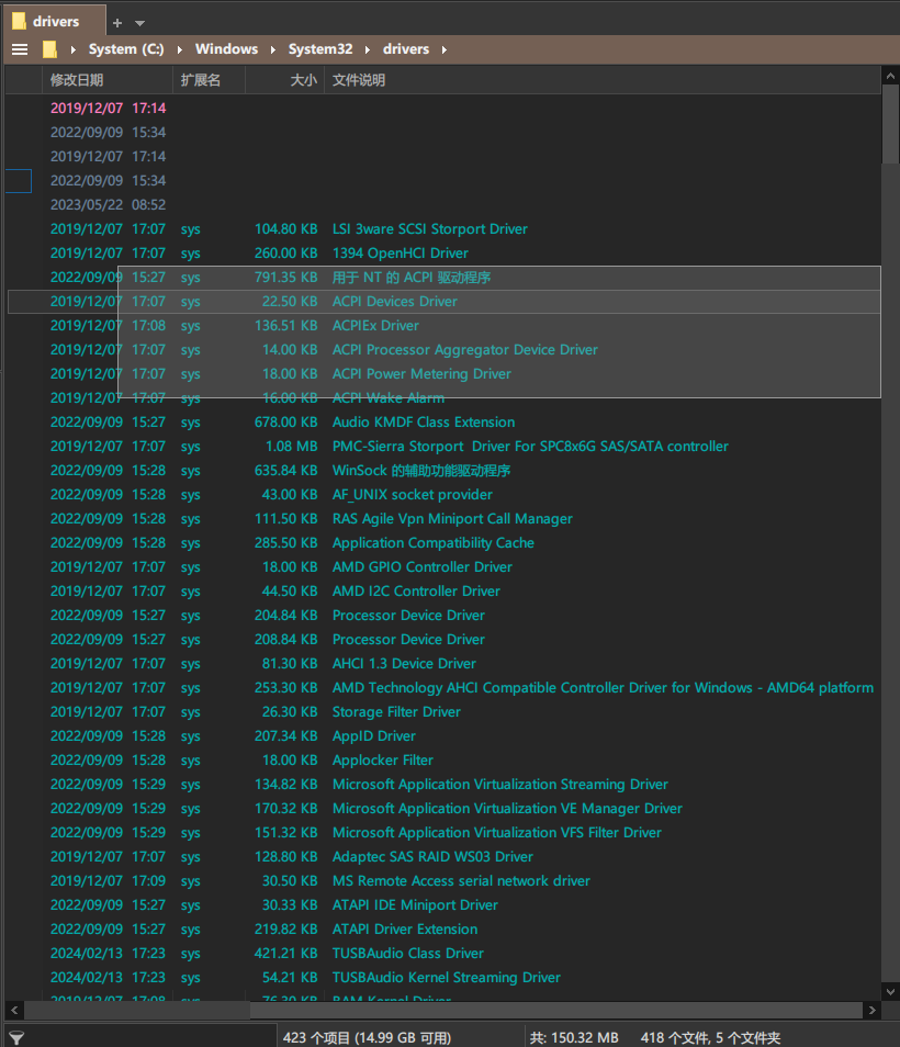

2. When there is a horizontal scrollbar, hold down the left mouse button and quickly move the mouse left and right to make the scrollbar move.

This can have so many causes (= so many types of work being triggered). Can you show a screenshot?

1) Does it make a difference if you remove that right-most column?
2) Does it make a difference if you turn off Color Filters?
Re: Performance lag starting from 26.40.0300
1) Deleting the column on the far right has no effect
2) Turning off the color filter has no effect
