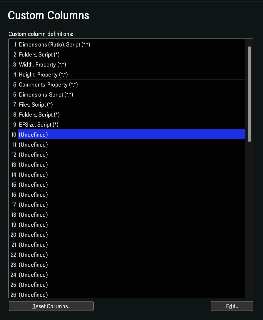

Ok so I am looking at my custom columns right now and the #6 one is Dimensions which I do have the (1. Dimensions (Ratio)) that I forgot I had which I guess I could use that instead but I need to have the ability to see the dimensions if I need to. Let me ask this, even though I might be in list view where it isn't showing any extra information like these custom columns, does it still mean that each file is still being checked to fill in that information?
And if so, can i switch to details view and then hide all the columns and then switch back to list view and it run faster?

Configuration | General | Sort and Rename | Sort | [x] Show sort headers in all viewsI might be in list view where it isn't showing any extra information like these custom columns
Yesdoes it still mean that each file is still being checked to fill in that information?
That's the way to goAnd if so, can i switch to details view and then hide all the columns and then switch back to list view and it run faster?

- Posts: 15016
Re: Program hardly Responds when in Certain Folders
v26.40.0203 - 2024-09-22 12:30
+ Menu View | Columns: Added toggle "Skip Custom Columns". Check it to not fill custom
columns in the current list. Custom columns are often time-consuming, especially
when scripts are involved. This new option allows you to temporarily disable this
service when the extra information is not needed.
As always, it's remembered across sessions.
Note that you can still manually populate a custom column by clicking "Refresh
Column" in the context menu of the column header.
