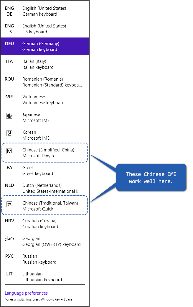

Posts: 65244
Re: Failed to rename a file or folder
I tested two Chinese IME that happened to be present on my system and both worked fine. I was able to type Chinese characters into the edit box without any problems.

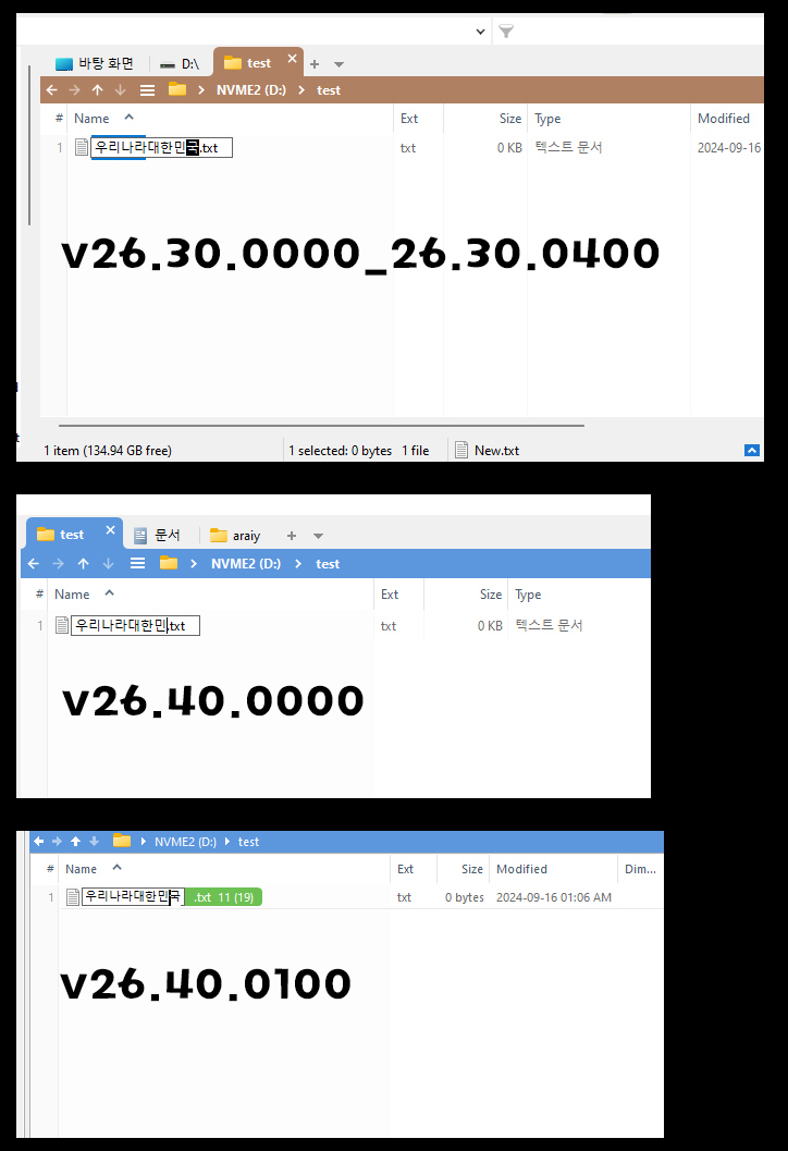

Post by Camilley »
Maybe it's a similar problem.
There was a problem when change filename in Korean (and Live filter box).
So I stopped using the 26.40.0000 version.
And now I just updated to 26.40.0100.
This problem never happened in previous versions. (at least in my memory)
So I tested it in 4 versions. (all free portable versions from official website)
All problems occur when entering Korean. It does not occur when entering English.
Normally, I would have tracked process of error occurrence, but I didn't track it because xyplorer is updated frequently.
v.26.30.0000 & v.26.30.0400
There is no problem at all.
v.26.40.0000
When change filenname, I entered consonant first time, It's not appear on the screen.
When entered one more consonant, the first time entered consonant is displayed. Consonant entered second time is not displayed.
If I enter 8 characters, only 7 characters are displayed on the screen.
And if I press enter key at this time, all 8 characters are displayed and change filename finished.
When I first updated to v.26.40.0000 and renamed filenames with korean, I got a lot of red alerts and critical errors. I don't know why... (cannot close alert box completely,, box popups again and again..) (I forgot to capture it. So Sorry... ㅠㅠㅠㅠㅠㅠㅠ)
Referentially.. In Korean, consonants and vowels are combined. and make single character.
우리나라 (U Ri Na Ra) -> ㅇ(consonant) + ㅜ(vowel) / ㄹ(consonant) + ㅣ(vowel) / ㄴ(consonant) + ㅏ(vowel) / ㄹ(consonant) + ㅏ(vowel)
v.26.40.0100
Problems that appeared in v.26.40.0000 has been fixed (at least so far...)
But the text cursor position is located in front of last input character, not behind the last input character. (This issue cause inconvenience when using the Live filter box.)

Posts: 65244
Interesting! :tup:

Posts: 65244
In v26.40.0200 I removed the recent changes. So it should work like v.26.30.0000 & v.26.30.0400 ("There is no problem at all."). Can you confirm that?
hesisiangchi_
Posts: 16
Joined: 18 Oct 2023 18:15
Post by hesisiangchi_ »
admin wrote: 19 Sep 2024 09:16 In v26.40.0200 I removed the recent changes. So it should work like v.26.30.0000 & v.26.30.0400 ("There is no problem at all."). Can you confirm that?
I had the same issue and it fixed in the v26.40.0200 version. good.
