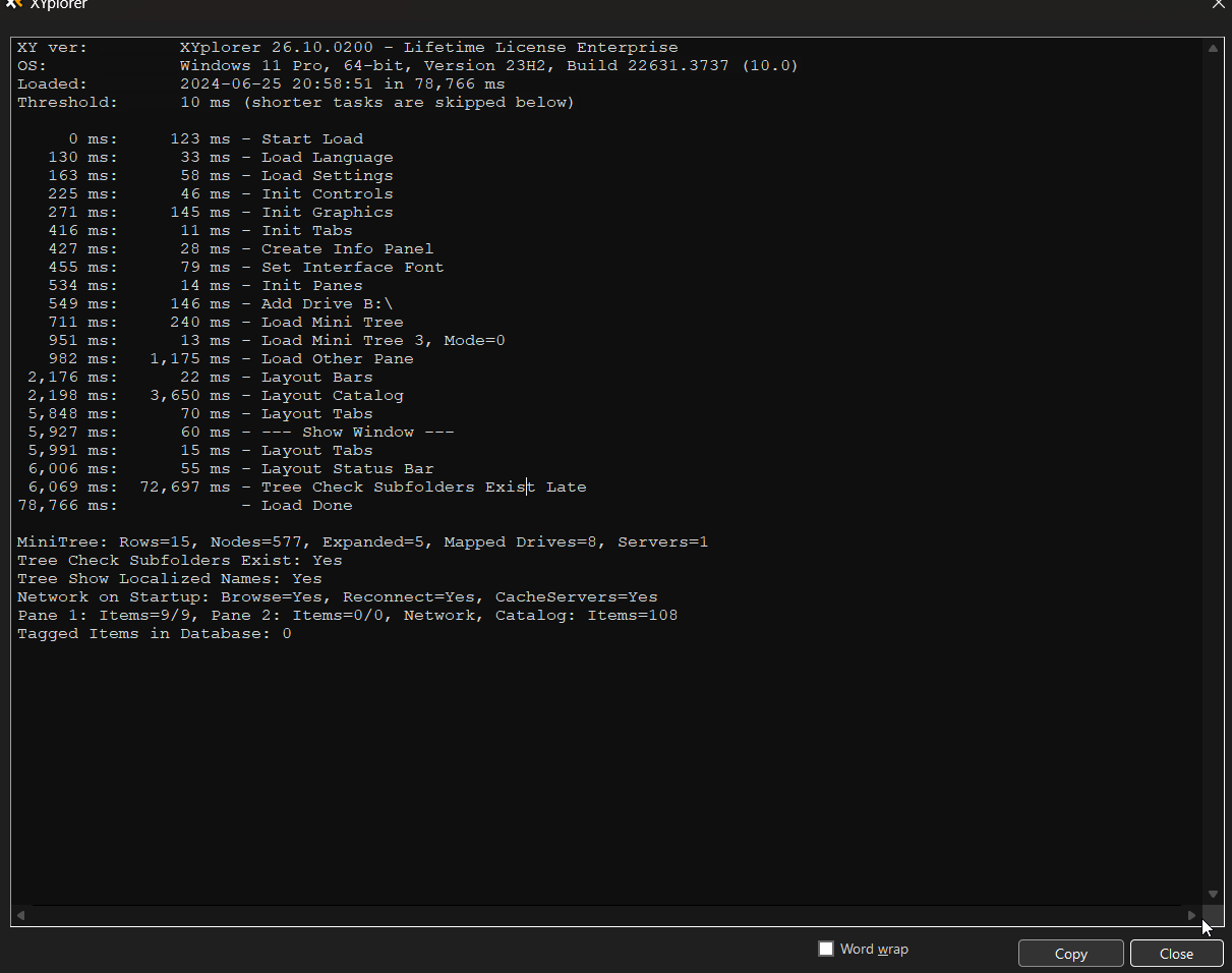

I was having this hanging issue as well with my work machine using v26, this after several years without this slowness with previous versions... unlike the other screenshots posted on here, mine shows nearly 80 second hang at startup.
After reviewing the load report results it was pretty obvious what the hangup was, the "check existence of subfolders in tree", once I turned that off in settings the program is flying again.
Right-clicking a file to bring up the context menu has also been slightly sped up, but it's still a quite bit slower than Windows Explorer - taking 3-6 seconds at times to pull up the context menu for any file regardless if it's local or on a network drive.

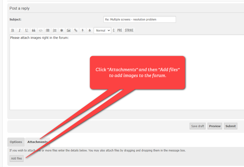

Attach images within the forum:

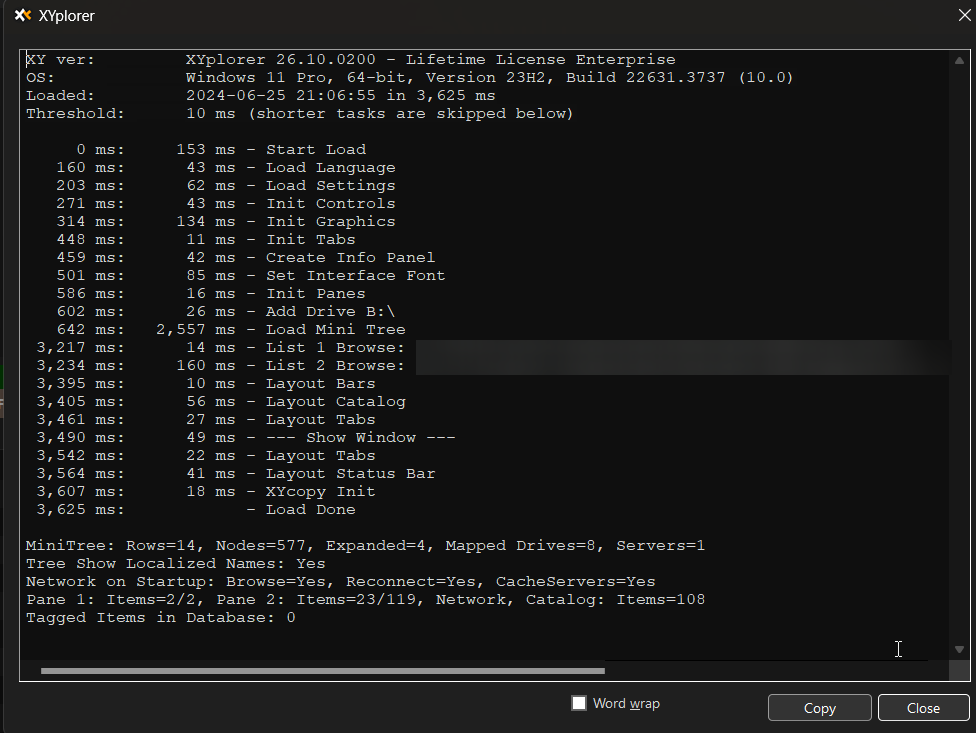

v26 original slow issue:
v26 after adjust the tree setup:
