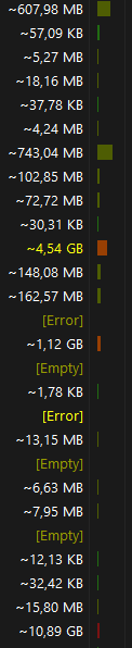

eil wrote: ↑08 Dec 2022 08:38 Well, the problem is that current implementation don't really serve its purpose - to let visually, just by glance, see which item is greater in size.
As i understand 4 blocks represent Small KB, Large KB, MB, GB - inside this groups difference is too tiny while differences in size are real big, so it's just misleading to use this representation.
That screenshot gave me an idea: It will feel more natural if it's done flipped, in the direction we know from Arabic numbers:

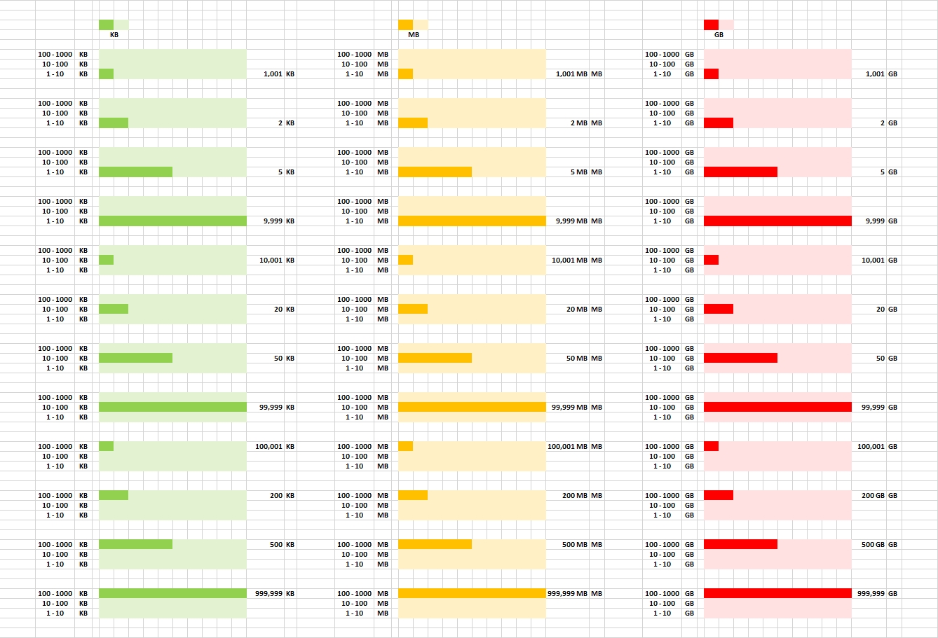

Hello everyone,
I am not using this feature.
But I still wanted to talk about my opinion on this subject.
Also, I've been pretty busy lately, so I haven't been able to read through the whole thread, I just skimmed the charts.
Sorry if I repeated the same idea.
I think that the graph to be added should not be complicated since the numeric quantities can already be displayed.
I think using too many colors in the same bar also creates confusion.
However, if we use only one color, the graph cannot give us enough information instantly.
So, I think using colors for units such as KB, MB and GB rather than using them for numerical sizes will help us to have an immediate knowledge of the size.
The pictures I added will best explain the use of colors.
Because as I mentioned before, I use "Google Translate" because my English is not good.
There is something I would like to explain regarding the pictures I sent.
In the pictures, I showed the sticks as 10 pieces, but that was just for clarification.
In summary;
Display of sticks as one piece.
Transfer of the size measure to the graphic in linear proportion.
As in the pictures; Using different colors for KB, MB and GB units.
This way we don't need to represent the file size logarithmically.
So, the comparison of two sizes in the same unit with each other can also be perceived visually.
I created 2 separate templates.
One is very simple.
The other is a little more detailed.
I hope you like one of them and find it worthy to apply.
Thank you for your interest.
