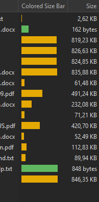

Recently, my bars show only outline, even if I explicitly set borderwidth to 0.
Running the current beta as of 2026-09-15.
Posts: 67111
Re: Size Column - Bar Colors
Got a screenshot?
christian777
Posts: 24
Joined: 05 Dec 2024 17:17
Location: Win 11 Pro N 25H2, no scaling
Post by christian777 »
Yep.
You can also see the tooltip with column info.
Posts: 67111
Thanks, got it. Fixed in next beta. :tup:
