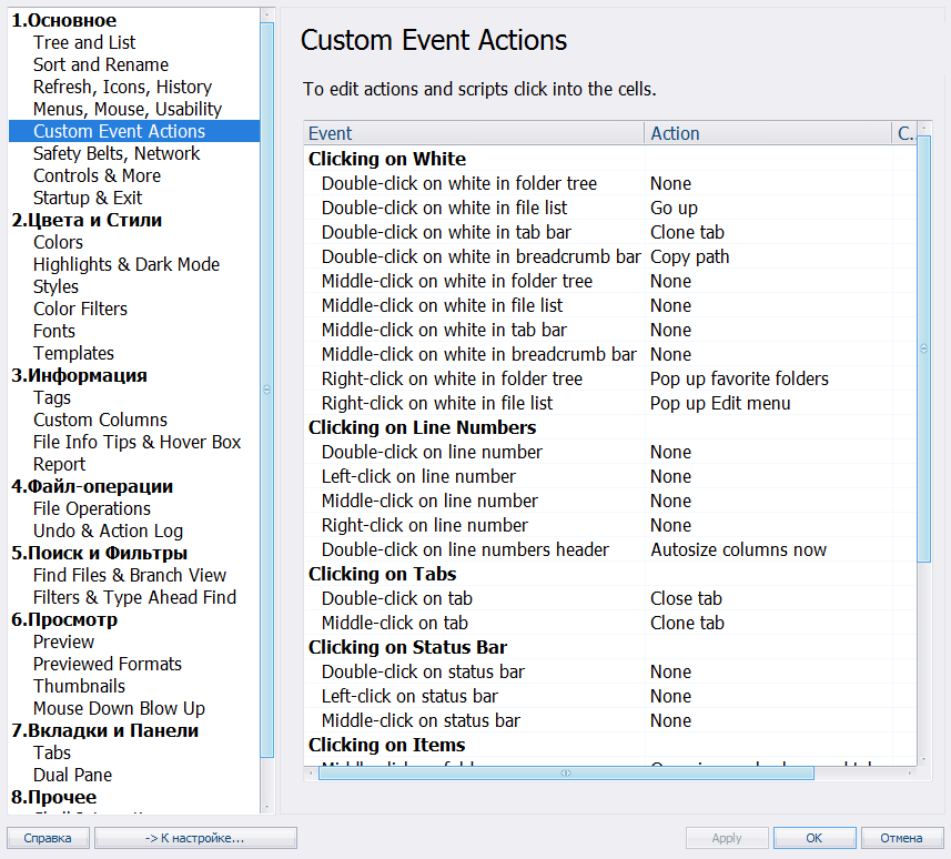

Please tell me another answer to one question (I did not find it in the settings and tweaks, maybe there is) – how to make the tab bar scroll if you turn the mouse wheel, and not switch to the next or previous tab? The translation into Russian in the program is not fully completed.

1) Tab bar scroll is not yet supported. It's planned.
2) Yes, Russian is not 100% complete. But your screenshot does not reflect the situation. All of this should be translated with the current version of Russian.

I checked the translation on the trial version, installing it from scratch. It turned out that the translation is more complete than when updating from the old version to the new one.
