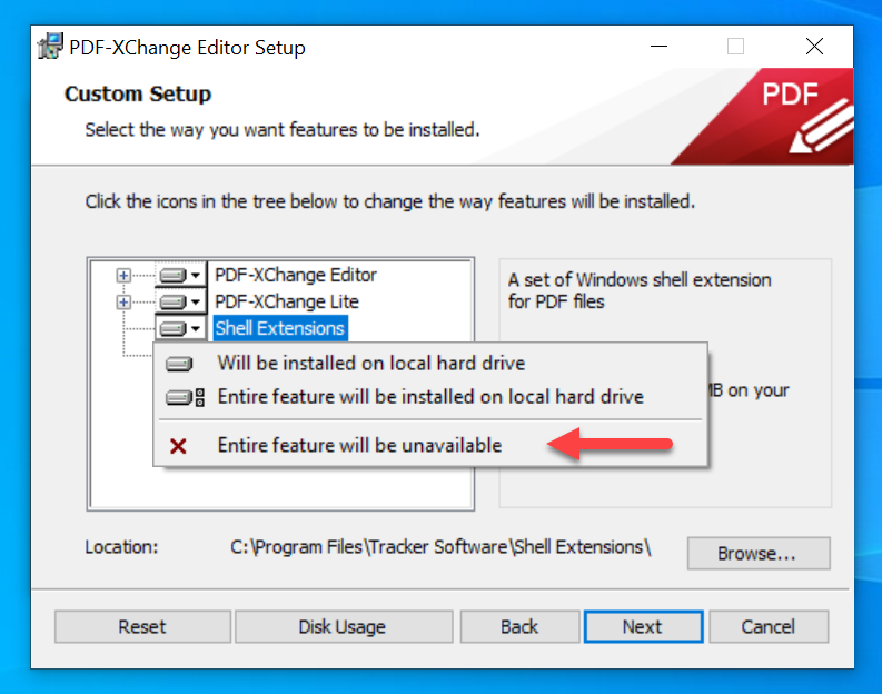

I'm still uncertain how XYplorer renders the MDBU preview - directly from the thumbnail or via the registered PDF preview handler. It appears to use the thumbnail directly and not interact with the PDF handler. That conclusion is based on observations in the next paragraph.
On the subject of the thumbnail cache and the location provided earlier, I've found that once those thumbnails are generated, that affects how XYplorer displays the preview. For example, it's known that the PDF-X Editor handlers have changed to the point that the previews are tiny now. But even if you remove that and install the viewer (with the known good PDF preview handler), the previews are still small. But, if you find that cache and remove the thumbnail files - it took me several tries since some were apparently "in-use" - then when you go back to XYplorer, instruct it to rebuild the thumbnail, then the preview is full size again.
So that's what led to allot of confusion for me initially. Mostly the behavior of "it works on some files not others". That was because once removing the editor and installing the viewer, as long as I picked folders which thumbnails had not yet been generated, they all worked. It was the folders that had the thumbnails created by the editor which were "stuck" in small preview mode - until I removed the Windows explorer cache files described earlier.
So, here's a workaround if you like/want to have both the editor and viewer installed. First, to avoid total confusion you have to start by wiping any thumbnails from the windows cache. Otherwise XYplorer will see/use them and not generate new ones - even if you tell it to Refresh Thumbnails.
If you have the editor already installed, remove it. You might want to remove the viewer too - just to start from a clean slate but that might not be necessary. Then, install the viewer with MINIMAL settings - considering you're only needing the PDF handlers installed/registered and you'll be using the editor for all your other PDF needs. That will install the handlers that allow XYplorer to display the previews and thumbnails. THEN, re-install the editor but choose CUSTOM during install and don't allow the shell extensions to be installed.
It's standard practice, but I'm still giving kudo's to Tracker Software for following standard practice when creating these installers to provide this flexibility. Thanks again to jupe as well for sharing the location of those pesky/sticky thumbnails!
Viewer install
Editor install
