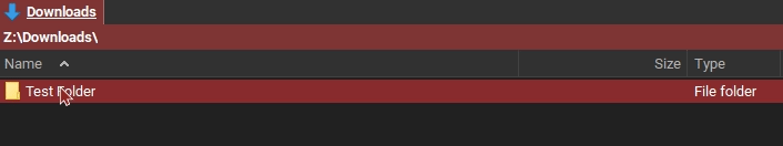

I'm experiencing the following issue: sometimes (maybe 5-10% of the time), when trying to open a subfolder in a new tab, that subfolder is not opened in a new tab, but instead changes the location of the current tab.
This happens both when using the middle mouse button to open a subfolder, and when a tab is locked and I'm using double-click to open a new tab.
To better visualize what I mean, here's a gif showing the latter case:
As you can see, the current folder "Downloads" (Z:\Downloads\) is locked. The first two times I'm double-clicking with the left mouse button, the "Test Folder" opens in in a new tab as it's supposed to (then I'm closing the tab). The third time, however, it fails and changes the locked tab's location from to Z:\Downloads\Test Folder\.
I'm currently running version 20.60.0200, but this has been happening ever since I started using XYplorer.
Here are my Tab settings in case it's relevant: https://pictshare.net/n10118.png.
Let me know if you need anything else.
Best regards.

"Downloads" is the only tab in that pane, and it's not defined as "default tab" (via right-clicking the tab header)?

yeah, in this example it's the only tab in the pane. I also experienced this issue with multiple tabs open.
And it's not defined as the default tab.

I tried hard (with my settings and with your settings) but could not reproduce it.

It seems I have solved this issue by doing something I probably should have done earlier.
At first, I've run my usual, registered XYplorer with a fresh configuration ("fresh;"), but the problem remained.
Then I tried a completely new installation of XYplorer, that is the trial version without registration and suddenly I wasn't able to reproduce the problem.
So I imported all my previous configurations except for the registration part in the XYplorer.ini, so it remained the trial version, and the problem still didn't re-appear.
Only when adding the registration info the problem occurred again.
I don't know how or why the registration details caused this, but I just registered again ("Update Registration Details...") and the problem seems to be gone for good now. Maybe I corrupted something in the past when backing up and restoring settings or something.
Anyway, thanks for your help and this great piece of software.
