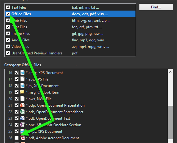

Klownboy earned an upgrade to the rank of KlownMan.klownboy wrote: ↑01 Jun 2019 01:27 Yeah, you should be able to page through the PDF files in the preview pane. I can using PDF XChange Viewer. Take a look at Configuration > Preview > Preview Formats. First look at what you have checked off for file formats under the category - "Office files" (in the top box, highlight Office Files). Look specifically for pdf files. There should be a check mark for *.pdf, PDF-XChange Viewer Documents provided that's still your PDF viewer or Foxit Phantom. Next look under the Category - "Text files". In that listing make sure that there is no check mark for PDF files in that category. See if that fixes the problem. If not I'd revert back to PDF XChange Viewer.

You un-ticked PDF in the "Office Files" and it works???
Re: Viewing multi-page PDF documents?
I installed PDF X-Change Viewer again.
Yes I:
1. Un-ticked PDF, Adobe in "Office files"
2. Removed the reference to Adobe in "Use-defined handler files"
3. Then added the preview handler as described in Method 2
Even though I am using PDF X-Change Viewer, the handler annotates with with a reference ot Adobe in the "User-defined handler files" field.
What I pasted was:
pdf>{CF822AB4-6DB5-4FDA-BC28-E61DF36D2583}
How it reports is:
*.pdf, Adobe Acrobat Document > {CF822AB4-6DB5-4FDA-BC28-E61DF36D2583}, PDF-XChange PDF Preview Provider
Even though I rebooted, it still references Adobe, but all is fine. This must be a label in the code.
I have used it for a few hours and all seems to be running great.

Yes I:
What I pasted was:
How it reports is:
