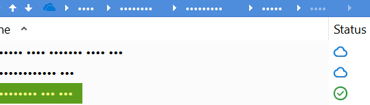

I have just clean installed the new version of Windows 10 1803 17133, ( successfully fixing my constant crashes :mrgreen: ) I have found that by using the following color filter you can color OneDrive Files which are downloaded and using space on your device a different color,
prop:#304:Available on this device
Cormorin wrote:Is there a way to search for these files ?
You can use that same string to find the files that are downloaded on your device.
If you wanted icons like in explorer I found the 3 most common icons and wrote a quick bare bones custom column, I didn't bother with sync pending state etc., If you want any enhancements you need to modify the script and add those yourself, if you want to try the custom column enter the following the address bar
snippet;
Please note this script only works on english OS as is, you will need to modify the english text of $state to suit your OS language, see my next post further down in this topic as to how to retrieve each state.
then add this in the dialog that opens:
Snip: CustomColumn 1
  XYplorer 18.90.0100, 12/4/18 7:01:39 PM
Action
  ConfigureColumn
Caption
  Status
Type
  3
Definition
      $state = property("#303", <cc_item>);				// WIN 1809+
      if ($state == "") { $state = property("#304", <cc_item>); }	// WIN 1803-
      if ($state == "Available on this device") {
       return "<xyicons>\od_dl.ico";
     } elseif ($state == "Available when online"){
       return "<xyicons>\od.ico";
     } elseif ($state == "Always available on this device"){
       return "<xyicons>\od_a.ico";
     } else { return ""; }
Format
  7
Trigger
  1
Item Type
  0
Item Filter
then add the custom column (look in the help file how) and I have attached the main 3 icon states icons, extract them all to your <xyicons> folder or adjust the paths in the above snippet.
edit: implemented minor performance changes, and included icon for 3rd state (Always available, not pictured)

To add the custom columns is that how you should do it?
2-10-2018 - 8.37.14 - 0001.png (20.4 KiB) Viewed 9908 times
Posts: 3296
Re: OneDrive on Windows 10
The instructions were in that post.
enter this in the address bar:
snippet;
then paste that text from that post in the popup dialog, then right click on the Name column header and select "Add Column", then right click the new "(Undefined)" column and select "Select Custom Column" and then select the Status custom column, which will be in that list now from the previous snippet; dialog step, (it will probably be #16 if you haven't added any non-default CCs before)
(or alternatively just grab that middle part of the text the stuff in the Definition section, and put it where you have added ALL the text in your screenshot)
