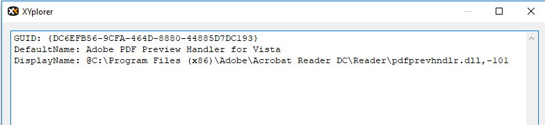

My PDF preview pane has also stopped working after XYplorer upgrade. Not sure if it is related. But I have tried the various items listed here except for installing the different previewer. My question is that what XYplorer thinks is the PDF previewer is different than the Configuration indications.
This "text get("previewhandler", "pdf");" shows the acrobat previewer and the Config file shows Foxit.
Anyway whatever is messed up keeps me from previewing any PDF's. Not good.
Posts: 3570
Re: PDF Preview Not Working, Other Files OK
A previewer can be different than the associated application, and usually is. And the only thing you say you haven't tried is what would fix it for you. There are many threads on the forum about this. Adobe preview handler is buggy, if you install a different preview handler but don't use is as a default application you will notice no difference except for the preview pane working, and you can leave Foxit as the default application for opening pdfs.
So that is how to solve your problem, more information :
