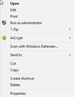

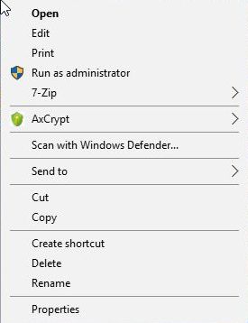

But there seems to be another problem, it is missing ''Rename" option? Original vs xyplorer.

Confirmed, missing for me too in 16.50.0200 on both Win10x64 and 2012R2

Yes, this is by design. (I'm sure I mentioned it in the change log when 64-bit context was added.) Rename would need a callback to XYplorer to open the inline rename box. This is not supported currently.
But really, does anybody here rename via context menu??? What's wrong about F2?
